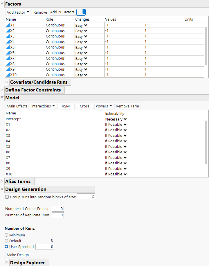

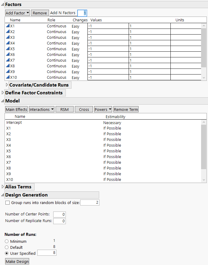

1. Select DOE > Custom Design.
2. Type 12 next to Add N Factors.
3. Click Add Factor > Continuous.
4. Click Continue.
5. In the Model section, select all terms except the Intercept.
6. Click Necessary next to any effect and change it to If Possible.
Setting the effects to If Possible ensures that JMP uses the Bayesian D-optimality criterion to obtain the design.
Figure 5.12 Factors, Model, and Number of Runs
7. In the Alias Terms section, select all effects and click Remove Term.
This ensures that only the main effects appear in the Color Map on Correlations. This plot is constructed once the design is created.

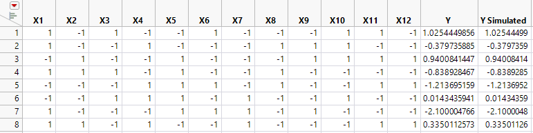

Figure 5.13 Design Table with Simulated Responses
The response columns, Y and Y Simulated, are initiated with the same simulated values. The values are random values from a N(0, s) distribution. where s is the RMSE from the power analysis with a default of 1. The Y Simulated values are updated with randomly generated values using the model defined by the parameter values in the Simulate Responses window. The Y column is intended for your true responses after the experiment has been run.

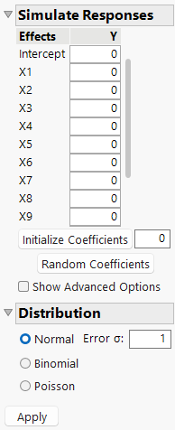

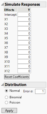

Figure 5.14 Simulate Responses Window
The Simulate Responses window shows default coefficients of 0 for all terms, a Normal distribution selection and Error σ of 1. The values in the Y and Y Simulated column currently reflect only random variation.

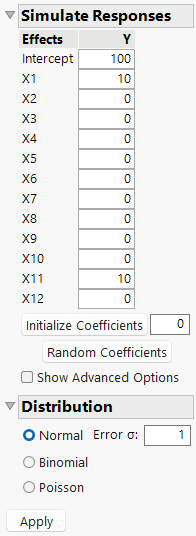

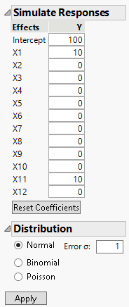

13. Change the values of the coefficients in the Simulate Responses window as shown in Figure 5.15.
Figure 5.15 Parameter Values for Simulated Responses
14. Click Apply.
The response values in the Y Simulated column change.
In your simulation, you specified X1 and X11 as active factors with large effects relative to the error variation. For this reason, your analysis of the data should identify these two factors as active.

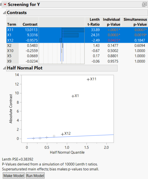

Figure 5.16 Screening Report for Supersaturated Design
The factors X1 and X11 have large contrast and Lenth t-Ratio values. Also, their Simultaneous p-Values are small. In the Half Normal Plot, both X1 and X11 fall far from the line. The Contrasts and the Half Normal Plot reports indicate that X1 and X11 are active effects. Although X12 has an Individual p-Value less than 0.05, its effect is much smaller than that of X1 and X11.
Because the design is supersaturated, p-values might be smaller than they would be in a model where all effects are estimable. This is because effect estimates are biased by other potentially active main effects. In Figure 5.16, a note warns you of this possibility.

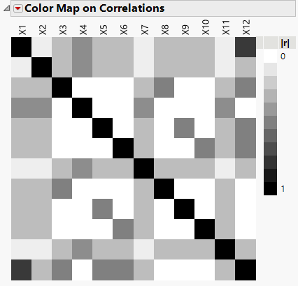

You can check whether the effects that appear active are highly correlated with other effects. When this occurs, one effect can mask the true significance of another effect. The Color Map in Figure 5.18 displays absolute correlations between effects.

6. In your Custom Design window, open the Design Evaluation > Color Map on Correlations section.
Figure 5.18 Color Map on Correlations
Hover over cells to see the absolute correlations. Notice that main effects are correlated with other main effects.
