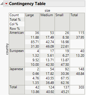

The Contingency Table is a two-way frequency table. There is a row for each level of the X variable and a column for each level of the Y variable.
Figure 7.6 Example of a Contingency Table

In Figure 7.6, focus on the cars that are large and come from America. The following table explains the conclusions that you can make about these cars using the contingency table.
Table 7.1 Conclusions Based on Example of a Contingency Table
Number
Description
Label in Table
36
Number of cars that are both large and come from America.
Count
11.88%
Percentage of all 303 cars that are both large and come from America (36/303).
Total %
85.71%
Percentage of the 42 large cars that come from America (36/42).
Col %
31.30%
Percentage of the 115 American cars that are large (36/115).
Row %
37.95%
Percentage of all 303 cars that come from America (115/303).
Total %
13.86%
Percentage of all 303 cars that are large (42/303).
Total %
