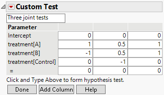

7. In the Custom Test specification report, click Add Column twice to create two additional columns. Each column is used to specify a contrast.
8. Fill in the editable area with a test name and enter values in the three columns as shown in Figure 4.48.
To see how to obtain these values, particularly those in the third column, see Interpretation of Parameters.
Figure 4.48 Custom Test Specification Report for Three Contrasts

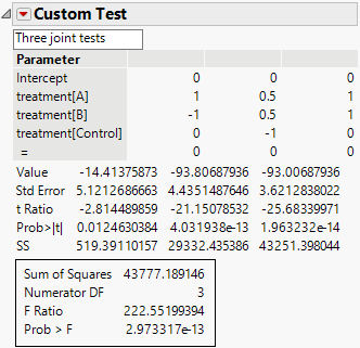

9. Click Done.
Figure 4.49 Custom Test Report Showing Tests for Three Contrasts
The results indicate that all three hypotheses are individually, as well as jointly, significant.
