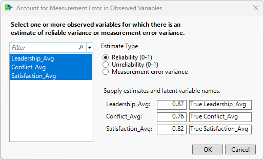

WeYou also know from prior studies that there is possibley measurement error in both the predictors (Leadership_Avg and Conflict_Avg) and the outcome (Satisfaction_Avg). Let’s aAssume that the estimates of reliable variance (Reliability) are 0.87 for Leadership_Avg, 0.76 for Conflict_Avg, and 0.82 for Satisfaction_Avg. Remember that you could use Unreliability to specify the estimates of reliable variance instead of Reliability. Alternatively, specific values could be used as the estimates of measurement error variance instead of Reliability/Unreliability proportions.

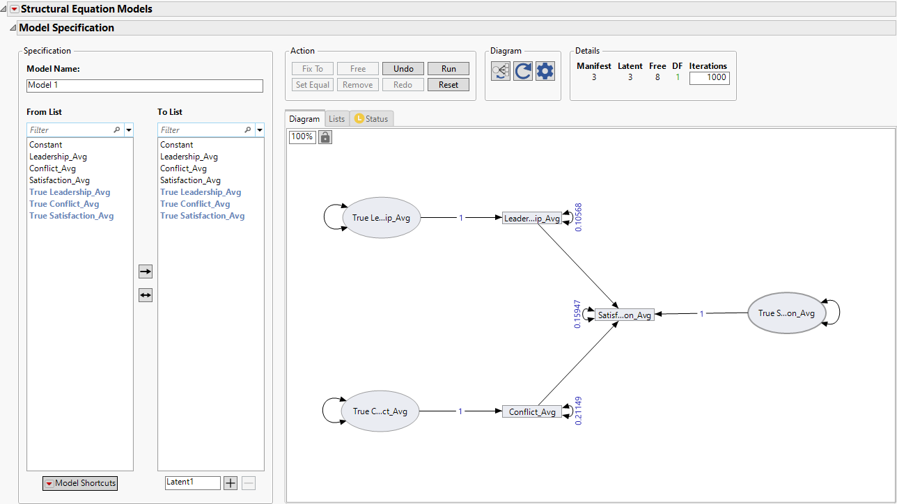

5. In the Model Specification report, sSelect Leadership_Avg, and Conflict_Avg in the From List, andselect Satisfaction_Avg in the To List, and click the unidirectional arrow
button.
Figure 8.17 Measurement Error Model Specification
Figure 8.18 Measurement Error Model Reliable Variance Estimates
Figure 8.19 Updated Measurement Error Model Specification

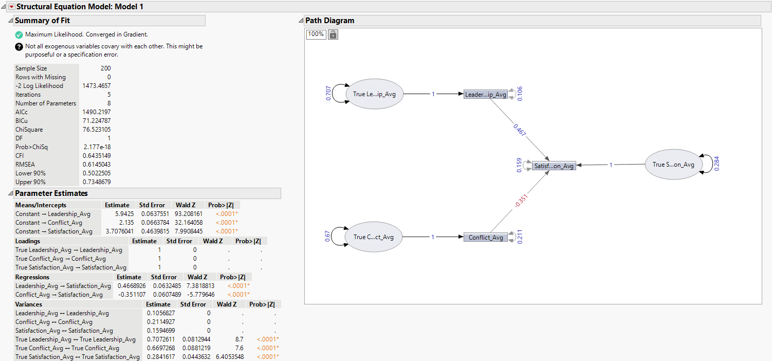

Figure 8.20 Measurement Error Model Report
Figure 8.21 Multiple Linear Regression Parameter Estimates
