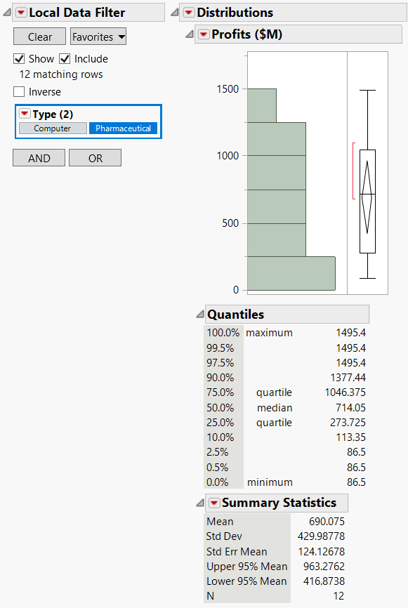

6. Click Type and click Add Image shown here.
7. In the Type box, click Pharmaceutical to see only their profits and then click Computer to see only their profits.
Figure 9.4 Local Data Filter Showing Pharmaceutical Profits
Note: The red triangle menu next to a variable contains options such as inverting the selection and displaying the values in a list of check boxes. See Red Triangle Options for Variables in Data Filters for more information.

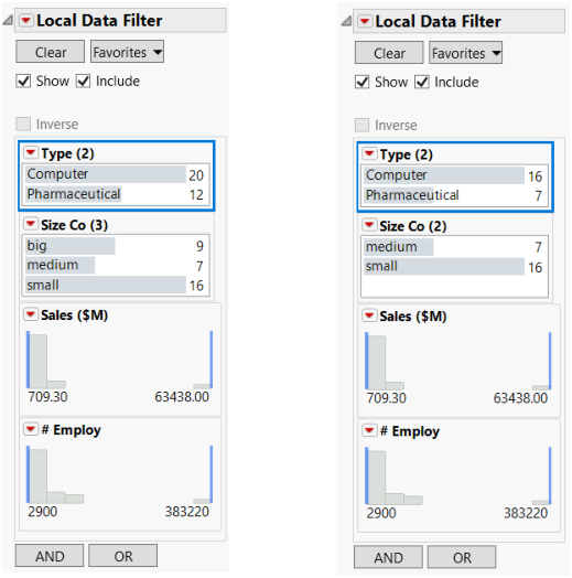

The counts for each level of a variable (including excluded rows) are shown in the Local Data Filter by default. To omit the excluded rows from the count, click the Local Data Filter red triangle and deselect Count Excluded Rows.
Figure 9.5 shows the difference between counting and omitting excluded rows. When the excluded rows are counted, the Local Data Filter shows 20 rows that contain the value “Computer”. Also, there are nine “big” values. When the excluded rows are omitted, only 16 rows contain “Computer”.
Figure 9.5 Counting (Left) and Omitting (Right) Excluded Rows
Note: The counts are not shown when Display Options is set to Blocks Display (Figure 9.4).
