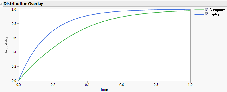

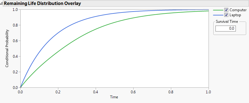

The Show Design Comparisons option displays a Distribution Overlay plot and a Remaining Life Distribution Overlay plot. These plots appear in the Workspace below the System Diagram. See Figure 12.12 and Figure 12.13.
• The Distribution Overlay plot shows the probability of system failure for each of the designs in the Designs panel.
• The Remaining Life Distribution Overlay plot shows the conditional probability of failure for each design in the Designs panel, given that the systems have survived to a specified survival time. Enter the Survival Time in the box to the right of the plot. Alternatively, select the small rectangle at the origin and drag it to the right to dynamically set the Survival Time.
Check boxes enable you to select which designs are represented in the plots. This enables you to compare a subset of designs with respect to failure probabilities.

Figure 12.12 Distribution Overlay Example
Figure 12.13 Remaining Life Distribution Overlay Example
