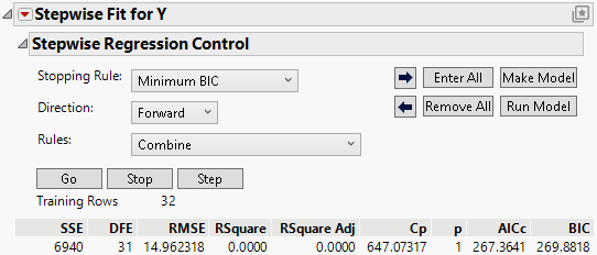

Use the Stepwise Regression Control panel to limit regressor effect probabilities, determine the method of selecting effects, begin or stop the selection process, and run a model. A note appears beneath the Go button to indicate whether you have excluded or missing rows.
Figure 5.3 Stepwise Regression Control Panel
Stopping Rule
The Stopping Rule determines which model is selected. For all stopping rules other than P-value Threshold, only the Forward and Backward directions are allowed. The only stopping rules that use validation are Max Validation RSquare and Max K-Fold RSquare. See Validation Options in Stepwise Regression.
P-value Threshold
Uses p-values (significance levels) to enter and remove effects from the model. Two other options appear when you choose P-value Threshold:
Prob to Enter
Specifies the maximum p-value that an effect must have to be entered into the model during a forward step.
Prob to Leave
Specifies the minimum p-value that an effect must have to be removed from the model during a backward step.
Note: If the specified Prob to Leave is less than the specified Prob to Enter, JMP uses the Prob to Enter value for both Prob to Enter and Prob to Leave.

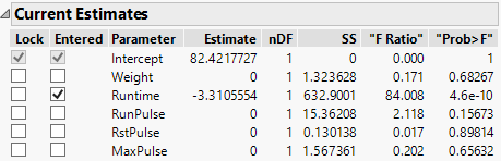

2. Click Step.
In Figure 5.4, you can see that after one step, the most significant term, Runtime, is entered into the model.

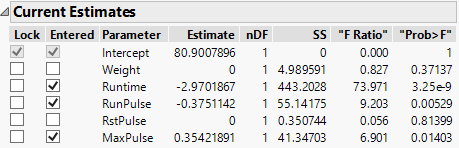

3. Click Go.
In Figure 5.5 you can see that all of the terms have been added, except RstPulse and Weight.
Figure 5.4 Current Estimates Table for Forward Selection after One Step
Figure 5.5 Current Estimates Table for Forward Selection after Three Steps

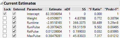

2. Click Enter All.
Figure 5.6 All Effects Entered into the Model

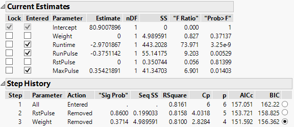

Figure 5.7 Current Estimates with Terms Removed and Step History Table
The Current Estimates and Step History tables shown in Figure 5.7 summarize the backward stepwise selection process. Note the BIC value of 156.362 for the third step in the Step History table. If you click Step again to remove another parameter from the model, the BIC value increases to 159.984. For this reason, you choose the step 3 model. This is also the model that the Go button produces.
