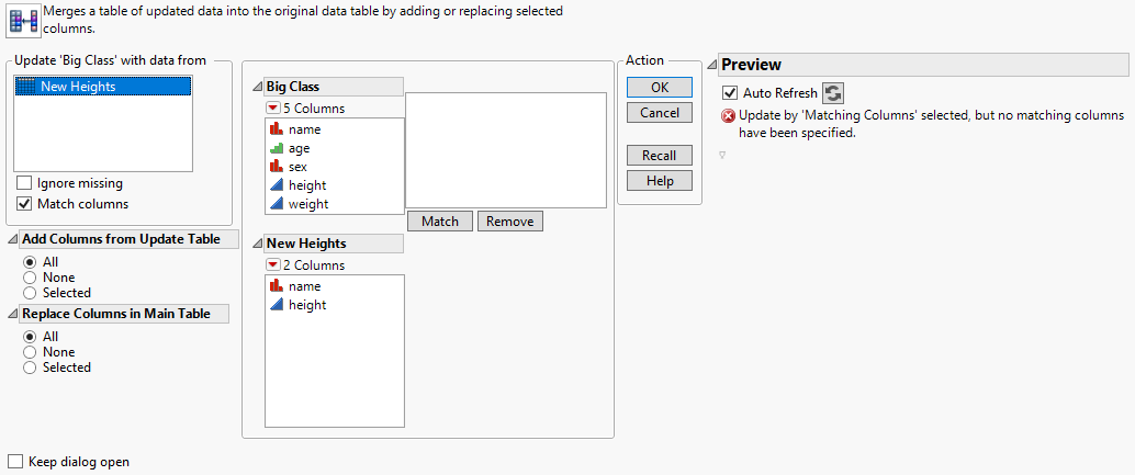

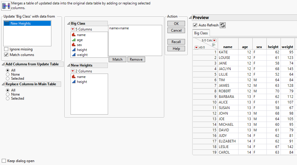

To update a table using matching columns
1. Follow the first three steps outlined in the previous section, To replace values in the active table with those found in another open table.
2. Select Match columns.
3. Highlight the two column names (in the respective tables) that you want to match.
4. Click Match.
Figure 6.46 Updating a Table with Matching Columns
5. (Optional) Repeat to match more columns.
6. Click OK.
Note: Columns that have different names from the columns in the table that you are updating (and that have not been assigned matches) are appended as separate columns. To avoid this problem, select the None option in the Add Columns from Update table area.
