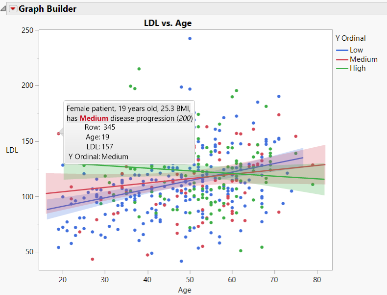

A textlet adds richly formatted text to the hover label in a JMP graph. You might use a textlet to describe data in an explanatory paragraph or to emphasize important information by making it bold or applying a color.
The textlet in Figure 12.39 shows text that is formatted in a gray box with red text.
Figure 12.39 Textlet Example
Textlet Example
The following script creates the textlet shown in Figure 12.39.
Names Default To Here( 1 );
dt = Open( "$SAMPLE_DATA/Diabetes.jmp" );
// create the baseline visualization
gb = dt << Graph Builder(
	Size( 534, 456 ),
	Show Control Panel( 0 ),
	Variables( X( :Age ), Y( :LDL ), Overlay( :Y Ordinal ) ),
	Elements( Points( X, Y, Legend( 8 ) ), Line Of Fit( X, Y, Legend( 10 ) ) )
// get a handle to the graph frame box
rpt = gb << Report;
frame = rpt[Framebox( 1 )];
/* configure the textlet -- a hover label extension that adds
	a rich text paragraph to the hover label. */
frame << Set Textlet(
    /* "Setup" is a JSL fragment that uses Hover Label Execution Contect
		variables to define content that will be embedded in the
		rich text paragraph.*/
	Setup(
		// map numerical values to text
		local:gender = If( Column( local:_dataTable, "Gender" )[local:_firstRow]
			== "1",
			"Male",
			"Female"
		// map a categorical value to text color
		local:color = Match( local:_Y Ordinal,
			"Low", "Medium Dark Blue",
			"Medium", "Medium Dark Red",
			"High", "Medium Dark Green"
		// capture values from other columns for the current row
		local:progression = Column( local:_dataTable, "Y" )[local:_firstRow];
		local:BMI = Column( local:_dataTable, "BMI" )[local:_firstRow];
	/* markup defines the rich text template. It supports HTML-like markup such as bold, italic and other font tags. Variable references between braces ({}) are substituted with their actual value. */
	Markup(
		"{local:gender} patient, {local:_age} years old, {local:BMI} BMI,
		has <font color='{local:color}'><b>{local:_Y Ordinal}</b></font>
		disease progression (<i>{local:progression}</i>)"
// pin a hover label to display a textlet-created rich text paragraph.
frame << Add Pin Annotation(
	Seg( Marker Seg( 2 ) ),
	Index( 64 ),
	Index Row( 344 ),
	UniqueID( 568154464 ),
	FoundPt( {96, 222} ),
	Origin( {18.68125, 156.93706122449} ),
	Tag Line( 1 )
Texlet Commands
See the example in Add Rich Text to Hover Labels Using Textlets for more information about writing texlet expressions.
