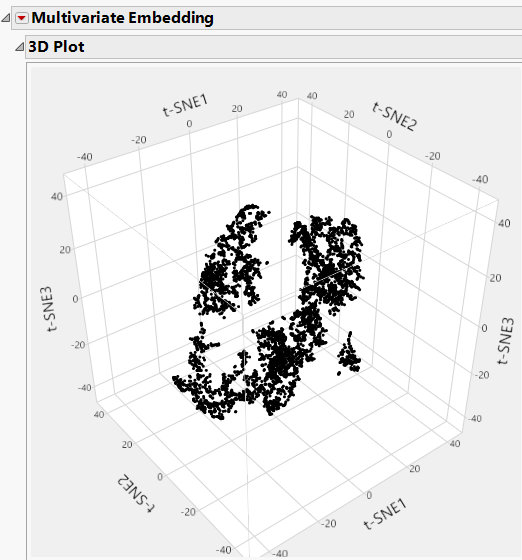

Figure 11.4 Example of a 3D t-SNE PlotĀ

Each 3D plot shows the coordinates for the first three embedded components of the corresponding dimensional reduction method. Comparing the UMAP and t-SNE method, the UMAP method took less computation time while also providing tighter clustering of the data. There are more distinct clusters visible in the 3D UMAP plot as compared to the 3D t-SNE plot in Figure 11.4.
Tip: You can rotate the grid to view the clusters more clearly.
