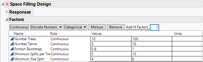

Next, you will add the tuning variables to the Factors section.
2. Click Continuous, change X1 to Number Trees and set the values to 10 to 100.
3. Click Continuous, change X2 to Number Terms and set the values to 5 to 10.
4. Click Continuous, change X3 to Portion Bootstrap and set the values to 0.8 to 1.
5. Click Continuous, change X4 to Minimum Splits per Tree and set the values to 5 to 10.
6. Click Continuous, change X5 to Minimum Size Split and set the values to 4 to 6.
Figure 5.12 Tuning Factors for Space Filling design

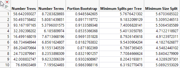

12. Click Make Table to generate your tuning design table.
Figure 5.13 Tuning Design Table
Tuning Design Table
Note: JMP rounds the design table entries to integers for use in the bootstrap platform.

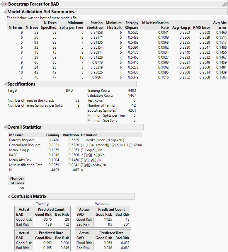

Ten bootstrap forests are built using the settings in the tuning design table. A summary table for all fits is provided as well as the details for the best model.
Figure 5.14 Tuning Table Bootstrap Forest Report for 10 Models
The Model Validation-Set Summaries report provides summary statistics for the validation set. Recall that the validation set was set to 25% of the data. The first forest listed has 58 trees and 8 terms sampled per split is the forest with the highest validation Entropy RSquare of 0.5525. This forest is selected as the best fit of the 10 forests and the performance of that forest is provided in the Overall Statistics section of the report.
