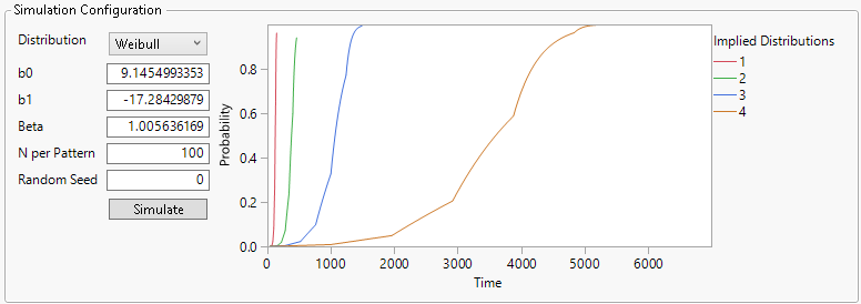

Figure 5.8 Simulation Configuration PanelĀ
The Simulation Configuration panel appears in the Stress Patterns report. The selection for Distribution is Weibull. The fitted values for b0 and b1 are used as initial values for the simulation.
4. Select Exponential for Distribution.
5. Enter 10 for b0.
6. Enter -18 for b1.
7. (Optional) Enter 14678 for Random Seed.
8. Click Simulate.

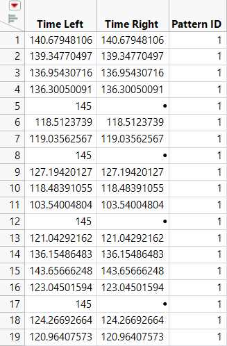

Figure 5.9 Partial Results of SimulationĀ
Figure 5.9 shows a partial listing of the simulated data table. The stress pattern with Pattern ID equal to 1 is defined only up to 145 time units. Since the Pattern Continuation setting in the launch window was set to Terminate, the simulation censors any simulated values at 145 for stress pattern 1.
