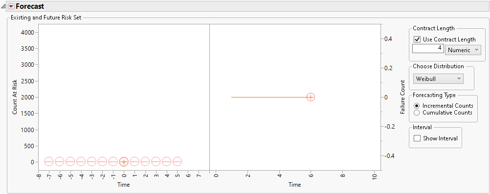

10. Set the past 7 months of production counts. In the left Forecast graph, drag the leftmost animated hotspot left to -7.
11. Set the future 5 months of production estimates. In the left Forecast graph, drag the rightmost animated hotspot right to 5.

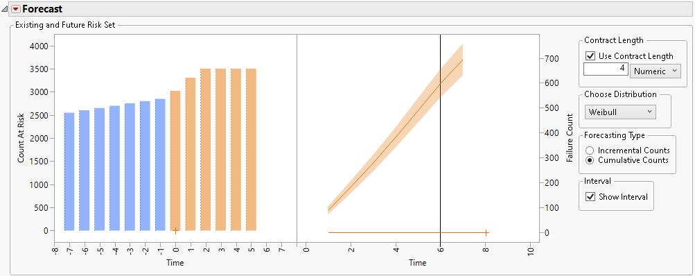

Figure 10.14 Risk Set after Dragging Animated Hotspots

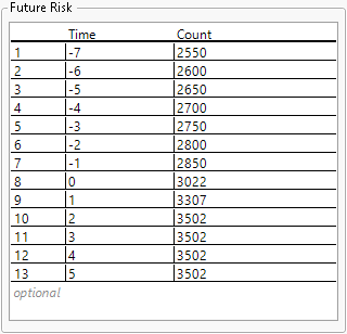

12. In the Forecast red triangle menu, select Spreadsheet Configuration of Risk Sets.
13. Drag the bottom of the Future Risk panel down so that you can see all 13 rows of the Future Risk table.
Note: When using time-to-event formatted data, the existing production quantities must be specified in the Future Risk table using negative numeric time values.
14. Type in the Count values that are shown in Figure 10.15.
Figure 10.15 Future Risk Count Specifications

The forecast for the total number of units that will be returned for repair in the next 6 months is approximately 600 with confidence interval about 550 to 650.
Tip: You can use the Save Forecast Data Table option in the Forecast red triangle menu to see exact values for the forecasts and intervals.
Figure 10.16 Forecast Results
Forecast Results
