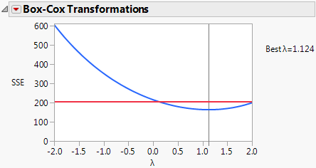

The Box-Cox Transformations report displays a plot showing the sum of squared errors (SSE) values against the values of λ. The horizontal red line on the plot represents a one-sided 95% confidence interval for λ. This confidence interval is based on the confidence region defined in Box and Cox (1964, p. 216). The confidence region is defined by the following inequality:

The plot in Figure 3.37 shows that the best values of λ are between 0.1 and 2.0. The value that JMP selects, using interpolation between the best two values in the 0.2-unit grid of λ values, is 1.124.
Tip: Use the Table of Estimates option in the Box-Cox Transformations red triangle menu to see the SSE values that were used to construct the Box-Cox Transformations plot.
Figure 3.37 Box-Cox Y Transformation
