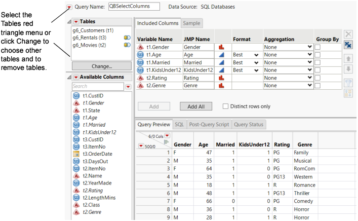

Suppose that you want to view movie rentals by movie genre, rating, and demographic data such as marital status and age.
Note: The Query Builder examples are based on a database that is not installed with JMP.
1. Select File > New > Database Query, connect to the database, and select the SQBTest schema. See Connect to a Database With Open Table.
2. In the Select Tables for Query window, select g6_Customers and click Primary.
3. Select g6_Movies and g6_Rentals and click Secondary.
4. Click Build Query to show the Query Builder window.
5. In the Available Columns box, select t1.Gender, t1.Age, t1.Married, t1.KidsUnder12, t2.Rating, and t2.Genre.
6. Click Add on the Included Columns tab.
Figure 3.39 Selected Columns
Selected Columns

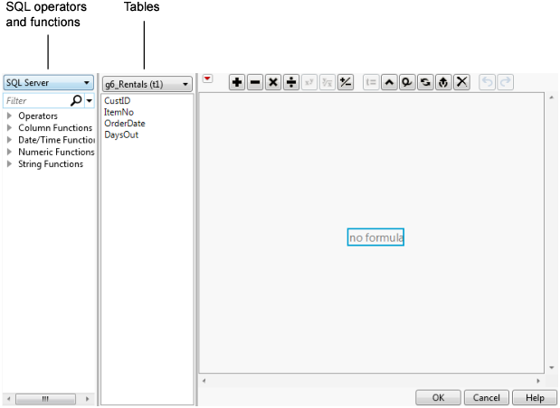

4. Click the Available Columns red triangle and select Add Computed Column.
The Computed Column window appears. The window contains the JMP Formula Editor.
Figure 3.40 Computed Column Window with Formula Editor
Notes:
– Operators and functions are provided in the list on the left side of the Formula Editor (Figure 3.40). In some instances, you might need to change the server type based on your database.
– The Operators list does not provide a Concatenate (||) operator. You must type the formula in the Formula Editor box.

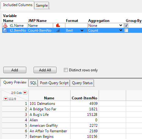

Suppose that you are interested in the number of times a specific movie was rented. In this example, the count for each item number is calculated, and common movie values are grouped into single rows.
1. Select File > New > Database Query, connect to the database, and select the SQBTest schema. See Connect to a Database With Open Table for.
2. In the Select Tables for Query window, select g6_Movies as the Primary table and g6_Rentals as the Secondary table.
3. Click Build Query to show the Query Builder window.
4. In the Available Columns box, select t1.Name and t2.ItemNo and click Add.
5. Select t2.ItemNo and select Count from the Aggregation list.
The Group By check box is selected for t1.Name. All instances of a specific movie name will be grouped into one row.
Figure 3.44 Grouped Columns
Grouped Columns
6. Click Run Query to import the data.
7. In the data table, right-click the Count-ItemNo column and select Sort > Descending.
Scarface was rented most frequently.

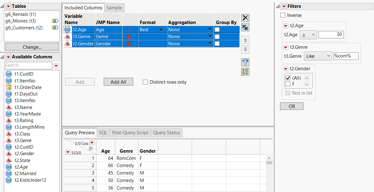

This example shows how to import data for age 30 and over customers, and movies in the RomCom and Comedy genres.
2. In the Select Tables for Query window, select g6_Rentals from the Available Tables list, and then click Primary.
3. Select g6_Customers and g6_Movies and then click Secondary.
5. In the Available Columns box, select t2.Gender, t2.Age, and t3.Genre, and then click Add on the Included Columns tab.
6. Select all columns on the Included Columns tab and click Add Selected Items to Filters Image shown here.
Filters for the columns appear in the Filters outline.
7. Set the t2.Age filter to ≥ 30.
8. Click the t3.Genre red triangle and select Like, type %com%, and press Enter.
The % wildcards match any number of characters before and after “com”. On the Query Preview tab, notice that movies in both the RomCom and Comedy genres are shown.
Figure 3.46 Selecting Filters
Selecting Filters
9. Click the Filters red triangle and select All Prompt on Run.
Users who run the query can customize the filters.
10. Click Run Query.
11. In the Query Prompts window, click OK to apply the preselected filters and import the data.

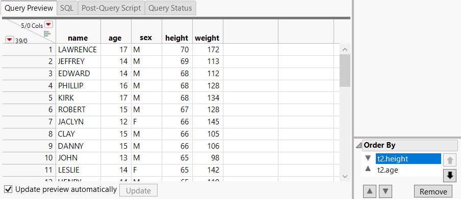

5. Select t1.age and t1.height and click Order by the Selected Items Image shown here.
The columns appear in the Order By outline in the right column.
The columns are sorted by age first (youngest to oldest) and then height (shortest to tallest).
Figure 3.48 Selecting the Order By Columns
6. In the Order By outline, select t1.height and then click Sort the values in descending order Image shown here below the columns.
The height column is sorted from tallest to shortest.
7. Select t1.height and click Move the Selected Items Up in the List Image shown here.
The height column is sorted first. Values in the age column are sorted within each level of height. For a height of 68, age is sorted from 14 to 17.
Figure 3.49 Result of Reordering Columns
