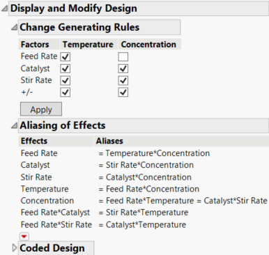

Figure 10.13 shows the default-generating rules for a 25-2 fractional factorial design (five factors and eight runs).
Figure 10.13 Generating Rules for the Standard 25-2 Design
In each column of the Change Generating Rules panel, the factor listed at the top and the factors in the column whose boxes are selected form a word in the defining relation. For example, the first column indicates that Temperature = Feed Rate*Catalyst*Stir Rate is a word in the defining relation.
• If the +/- box is selected, the sign associated with the generating rule is positive and the corresponding word equals the identity.
• If the +/- box is not selected, the sign associated with the generating rule is negative and the corresponding word equals minus the identity.
See Obtain the Defining Relations in the 25-2 Design.
The principal fraction of a full factorial design is the fractional factorial design obtained by setting all the defining relations equal to the identity. By default, the factorial design that JMP provides is the principal fraction. Notice that the +/- box is selected by default for all generating rules, so that each word in the defining relation equals the identity.
Figure 10.13 shows two columns of check boxes:
• The first column represents the word Temperature = Feed Rate*Catalyst*Stir Rate.
• The second column represents the word Concentration = Catalyst*Stir Rate.
Define I to represent a column consisting of the values +1. Because all factor levels are -1 or +1, the word in the first column is equivalent to Temperature*Feed Rate*Catalyst*Stir Rate = I. The word in the second column is equivalent to Concentration*Catalyst*Stir Rate = I. Together, these give the defining relations for the 25-2 design:
I = Temperature*Feed Rate*Catalyst*Stir Rate = Concentration*Catalyst*Stir Rate
Obtain the Aliasing of Effects Relations in the 25-2 Design
The aliasing structure in the Aliasing of Effects section is determined by the defining relations and the fact that factor levels are +1 and -1. Recall that the first generating rule is Temperature = Feed Rate*Catalyst*Stir Rate and the second is Concentration = Catalyst*Stir Rate.
To obtain the first relation in the Aliasing of Effects section, notice that applying these two generating rules gives the expression:
Temperature = Feed Rate*Catalyst*Stir Rate = Feed Rate*Concentration
– The second equality follows from replacing Catalyst*Stir Rate by Concentration using the second generating rule.
Now, post-multiply the first and third expressions by Concentration to obtain the following expression:
Temperature*Concentration = Feed Rate*Concentration*Concentration
Because the column for Concentration in the design matrix contains values of -1 and +1, the term Concentration*Concentration represents a column of +1 values. The expression becomes the first alias relation shown in the Aliasing of Effects section:
Temperature*Concentration = Feed Rate*I = Feed Rate
The other alias relations can be obtained using similar calculations.
