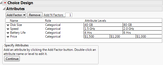

2. Select Help > Sample Data Folder and open Design Experiment/Laptop Factors.jmp.
3. Click the Choice Design red triangle and select Load Factors.
Figure 18.4 Choice Design Window with Attributes Defined

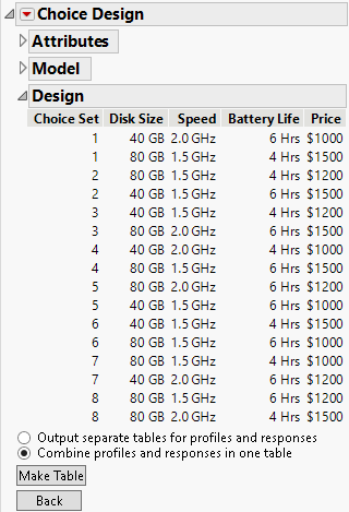

4. Click Make Design.
Note: Setting the Random Seed in step 3 reproduces the exact results shown in this example. In constructing a design on your own, this step is not necessary.
Figure 18.5 Pilot Design
Pilot Design
The single survey contains eight choice sets, each consisting of two laptop profiles.
5. Verify that the Combine profiles and responses in one table option is selected.
This places the choice sets and the survey results in the same table.
6. Click Make Table.
