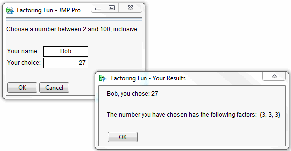

Using JSL, you can gather numeric input from users, perform a calculation on the input, and show the results in a new window.
Prime Numbers.jsl asks the user to enter a number and then factors the number or confirms it as a prime number (Figure 18.5). This script is a good example of aligning several types of display boxes, concatenating text, and working with conditional functions.

Figure 18.5 Factor Numbers Interactively
