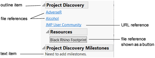

Figure 11.30 shows some of the items that you can add to a journal.
Figure 11.30 Example of a Journal
