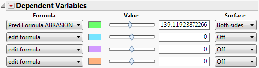

Controls for Isosurface
Most of the controls for Isosurface are identical to those of Sheet, points. Figure 5.10 shows the default controls, illustrating the slightly different presentation.
Figure 5.10 Dependent Variable Controls for Isosurfaces
Value
Slider and text box that activate an isosurface for the dependent variable. You can use the slider to adjust the value at which the isosurface is drawn. You can also enter the value into the text box next to the slider.
