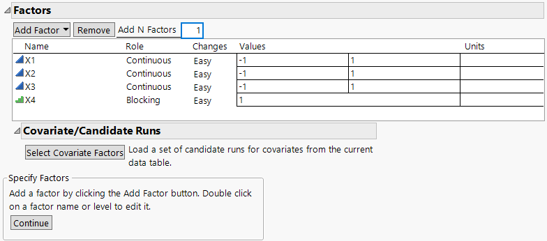

4. Click Add Factor > Blocking > 3 runs per block.
The blocking factor X4 shows only one level under Values. This is because the run size is unknown at this point.
Figure 5.19 Factors with One Block for X4

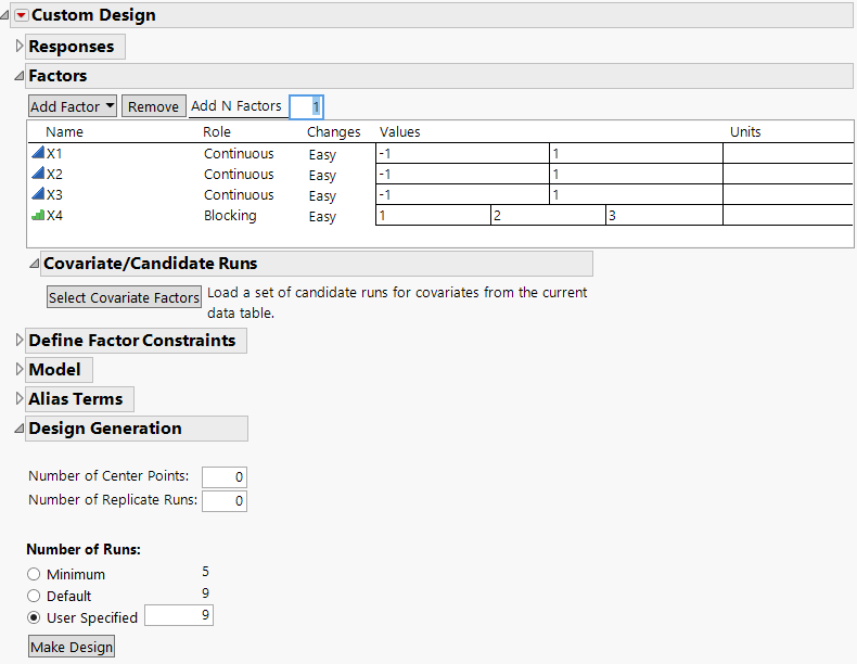

5. Click Continue.

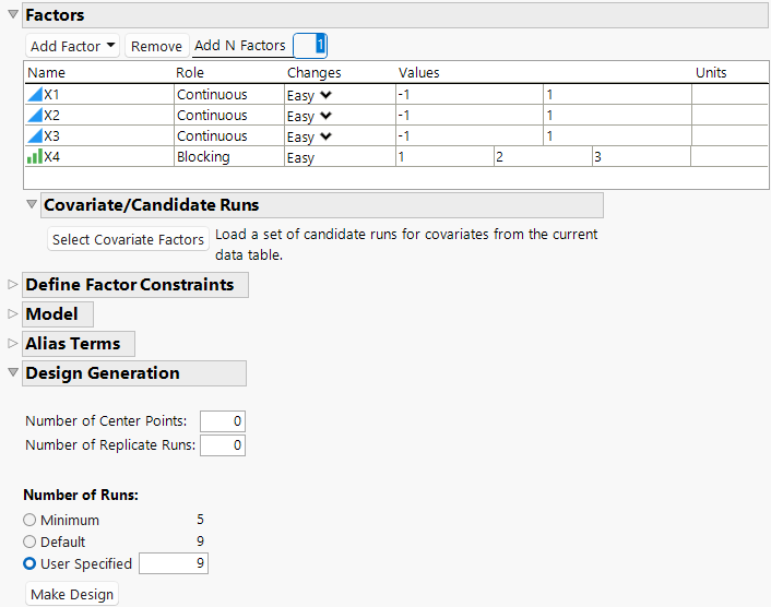

Figure 5.20 Factors with Three Blocks for X4
The Factors section now shows an appropriate number of blocks, calculated as the Default run size divided by the number of runs per block. For this example, the default sample size of 9 requires three blocks. The Factors section now shows that X4 has three values, indicating the three blocks.
Note: If you specify a different number of runs, the Factors section updates to show the appropriate number of values for the blocking factor.

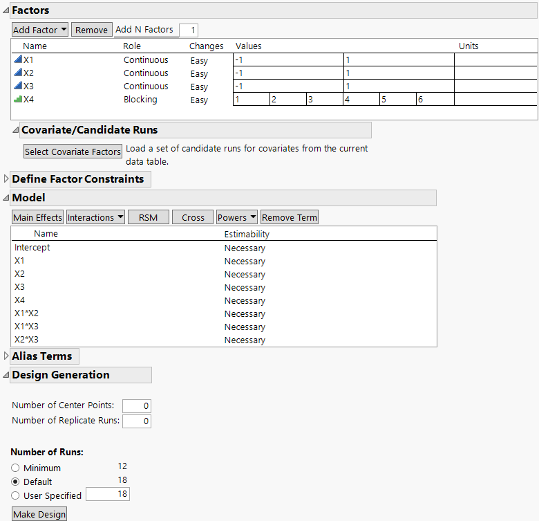

6. Select the three continuous factors, X1, X2, and X3, in the Factors section.
7. In the Model section, click Interactions > 2nd.

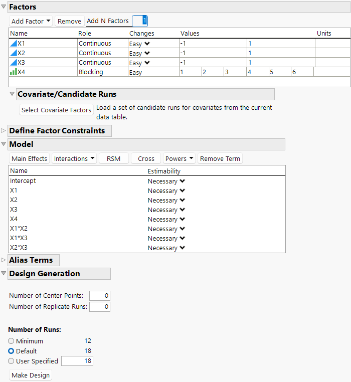

Figure 5.21 Factors with Six Blocks for X4
The Number of Runs panel now shows that 18 is the Default run size. The Factors section now shows six values for X4, indicating six blocks.

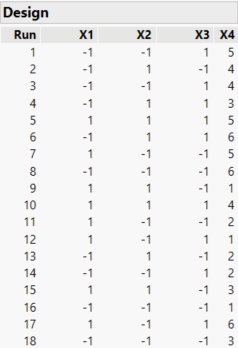

10. Click Make Design.
Figure 5.22 Fixed Block Design
Fixed Block Design
In the design, look at the blocking factor, X4. The six blocks are represented. When you conduct your experiment, each day has three trials, where X4 = 1 on the first day, X4 = 2 on the second day, and so on. You want the design table to randomize the trials within blocks. In the Output Options panel, the Randomize within Blocks option is already selected for Run Order.

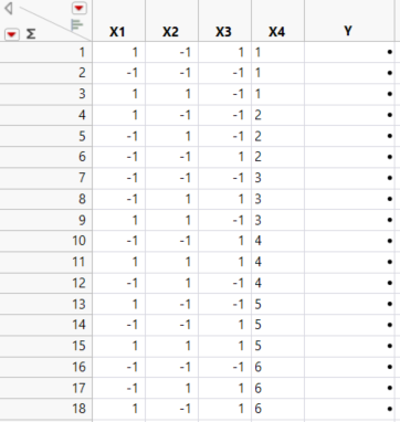

11. Click Make Table.
Figure 5.23 Design Table for Fixed Block Design
The rows in the design table are grouped by each day’s runs. This design enables you to estimate the block effect, all main effects, and two-factor interactions.
