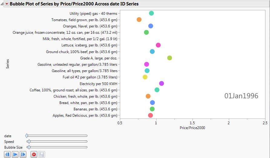

All of the examples so far use continuous Y variables. If you use a categorical (nominal or ordinal) Y variable, the bubble plot appears differently. This example contains data that shows the price of commodities over several years in US dollars. Because the value of the dollar changes over time, a column named Price/Price2000 shows the ratio of a commodity’s price at any given time to the price in the year 2000.
1. Select Help > Sample Data Folder and open blsPriceData.jmp.
2. Select Graph > Bubble Plot.
3. Select Series and click Y.
4. Select Price/Price2000 and click X.
5. Select date and click Time.
6. Click OK.
The report window appears. (Figure 5.15 uses the JMP default colors.)
This produces a bubble plot that, when animated by clicking the play button, shows the price bubbles moving side to side according to their price ratio.
Figure 5.15 Static Example of Animated Bubbles
