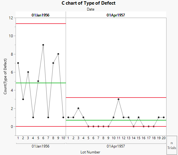

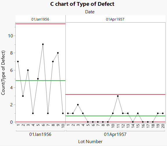

Figure 3.31 C chart of Type of Defect with Phases
You can now view the results on the two different days. Both appear to be within limits. You can also examine other defect type behavior using the Event Chooser.

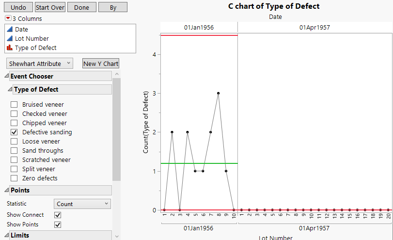

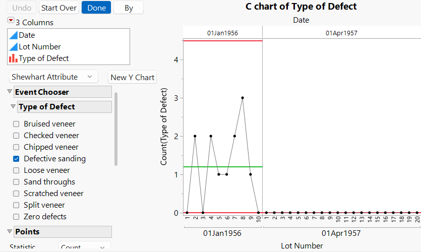

Figure 3.32 C Chart of Defective Sanding Defect Type
This chart shows that all of the events corresponding to the Defective sanding defect type occurred on the first day, 01Jan1956.
