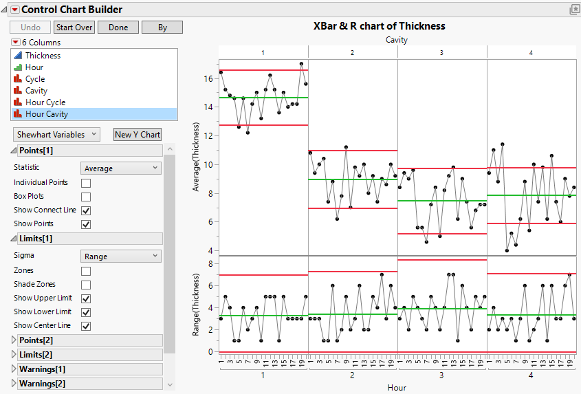

Figure 3.1 Control Chart Builder Example
