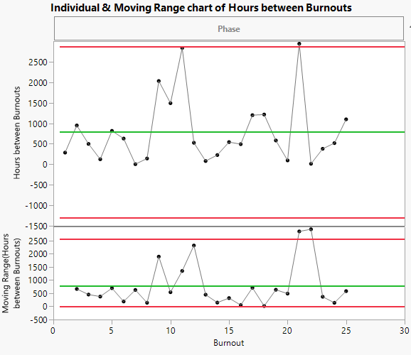

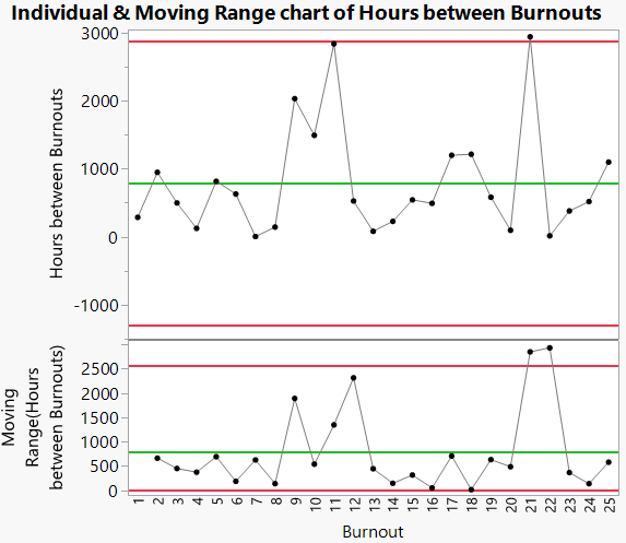

Figure 3.35 Individual and Moving Range Chart of Hours Between Burnouts

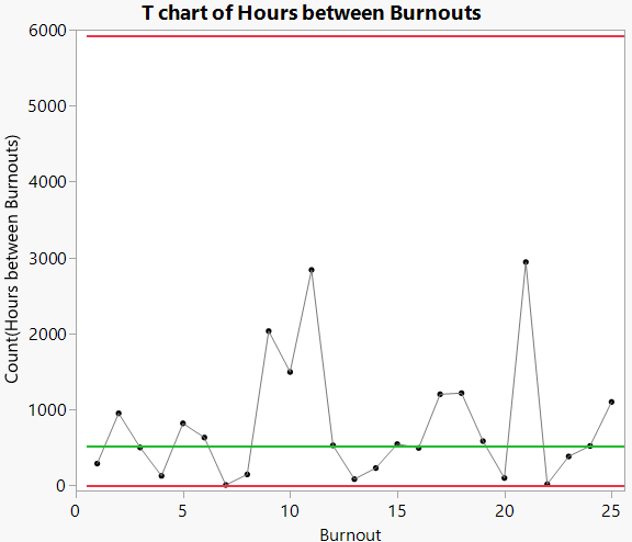

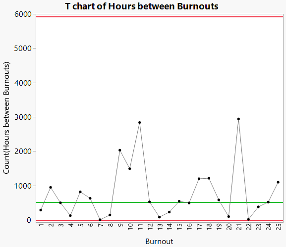

5. In the drop-down list, select Rare Event instead of Shewhart Variables.
6. Under Limits, change the Sigma from Negative Binomial to Weibull.
Figure 3.36 T chart of Hours Between Burnouts
In the T chart, all points appear to be within the control limits. It is clear that the Individual & Moving Range chart was inappropriate for the analysis, as the limits were too narrow.
