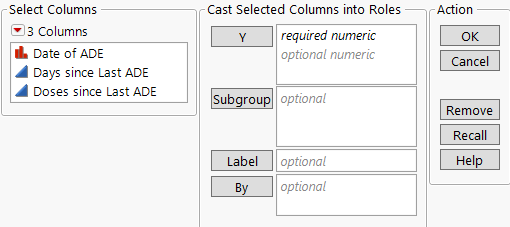

Figure 3.5 Launch Window for Variable Control Charts

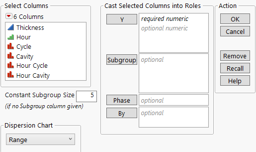

Constant Subgroup Size
(Available only for XBar and Three Way charts.) Specifies a number of observations that make up each subgroup. If the number of observations per subgroup is not constant, you should specify a column in the Subgroup role.
Note: If you specify a Subgroup variable, the platform ignores the setting for the Constant Subgroup Size option.
Dispersion Chart
(Available only for XBar charts.) Specifies the type of dispersion chart that appears below the XBar chart. You can choose between no dispersion chart, a range chart (XBar & R), or a standard deviation chart (XBar & S).

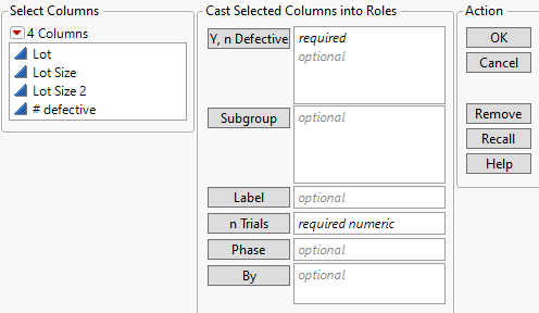

Figure 3.6 Launch Window for Attribute Control Charts
Y, n Defective
(Available only for P, NP, and Laney P′ control charts.) Assigns the process variables.
Y, n Defects
(Available only for C, U, and Laney U′ control charts.) Assigns the process variables.

n Trials
Assigns the subgroup sample size.

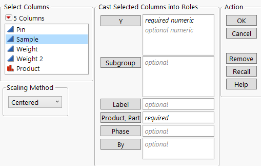

Launch Window for Short Run Control Charts
This section contains information about the launch windows for Short Run Control Charts.
Figure 3.7 Launch Window for Short Run Control Charts

Product/Part
Assigns the Product/Part variable. When a Part variable is assigned, statistics are calculated for each product, or level of the Part variable. These statistics are used to calculate the control limits.

Scaling Method
Specifies the scaling method for the control chart. The options are Centered and Standardized.
