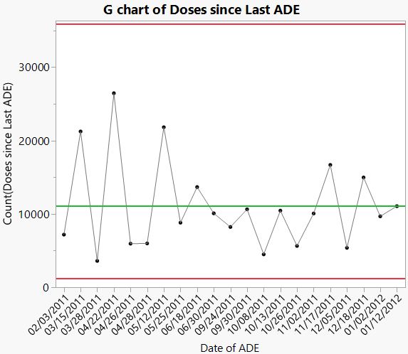

In this example, you use the interactive workspace in Control Chart Builder to create a G chart to monitor data about adverse drug events (ADEs) reported by a group of hospital patients. An ADE is any type of injury or reaction the patient suffered after taking the drug. The date of the reaction and the number of days since the last reaction were recorded.
A G chart is an effective way to understand whether rare events are occurring more frequently than expected and warrant an intervention. See Rare Event Control Charts.

An Individual & Moving Range chart of Doses since Last ADE appears.
5. In the drop-down list, select Rare Event instead of Shewhart Variables.
A G chart of Doses since Last ADE appears, showing the number of doses given since the last event.
Figure 3.34 G chart of Doses since Last ADEĀ
