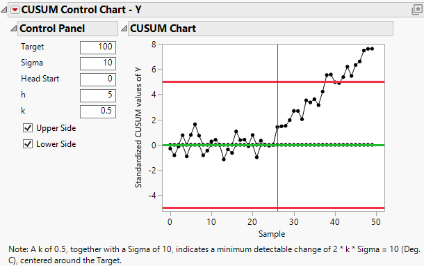

In this example, you want to detect small shifts in the temperature of an engine. The data table contains temperature measurements from the engine thermostat.
1. Select Help > Sample Data Folder and open Quality Control/Engine Temperature Sensor.jmp.
2. Select Analyze > Quality and Process > Control Chart > CUSUM Control Chart.
3. Select Y and click Y.
4. Click OK.
5. In the Target box, type 100.
6. In the Sigma box, type 10.
Figure 10.2 CUSUM Control Chart ReportĀ
The vertical line on the CUSUM Chart indicates that a shift in the temperature measurements started around sample 26.

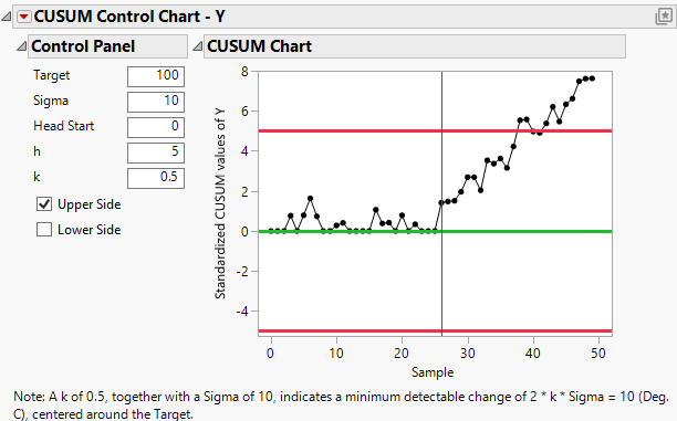

Continuing the previous example, suppose that you care only about increasing temperature changes. To change the CUSUM control chart in Figure 10.2 to a one-sided chart, deselect the Lower Side check box. When you do that, the points for the negative cumulative sums are removed from the chart. You are left with a CUSUM control chart that contains only the positive cumulative sum points.
