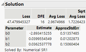

The platform used the Numerical SR1 method to obtain the parameter estimates shown in Figure 15.17.
Figure 15.17 Solution for the Ingots2 Data
