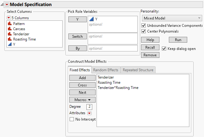

5. Select Tenderizer and Roasting Time, and then select Macros > Full Factorial.
Figure 8.27 Fit Model Launch Window Showing Completed Fixed Effects Tab

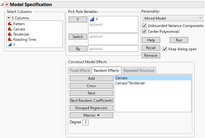

6. Select the Random Effects tab.
7. Select Carcass and click Add to create the random carcass effect.
8. Select Carcass and Tenderizer and click Cross.
The Carcass*Tenderizer interaction is the error term for the whole plot factor, Tenderizer. This is equivalent to the Carcass*Tenderizer&Random term in Standard Least Squares.
Figure 8.28 Fit Model Launch Window Showing Completed Random Effects Tab

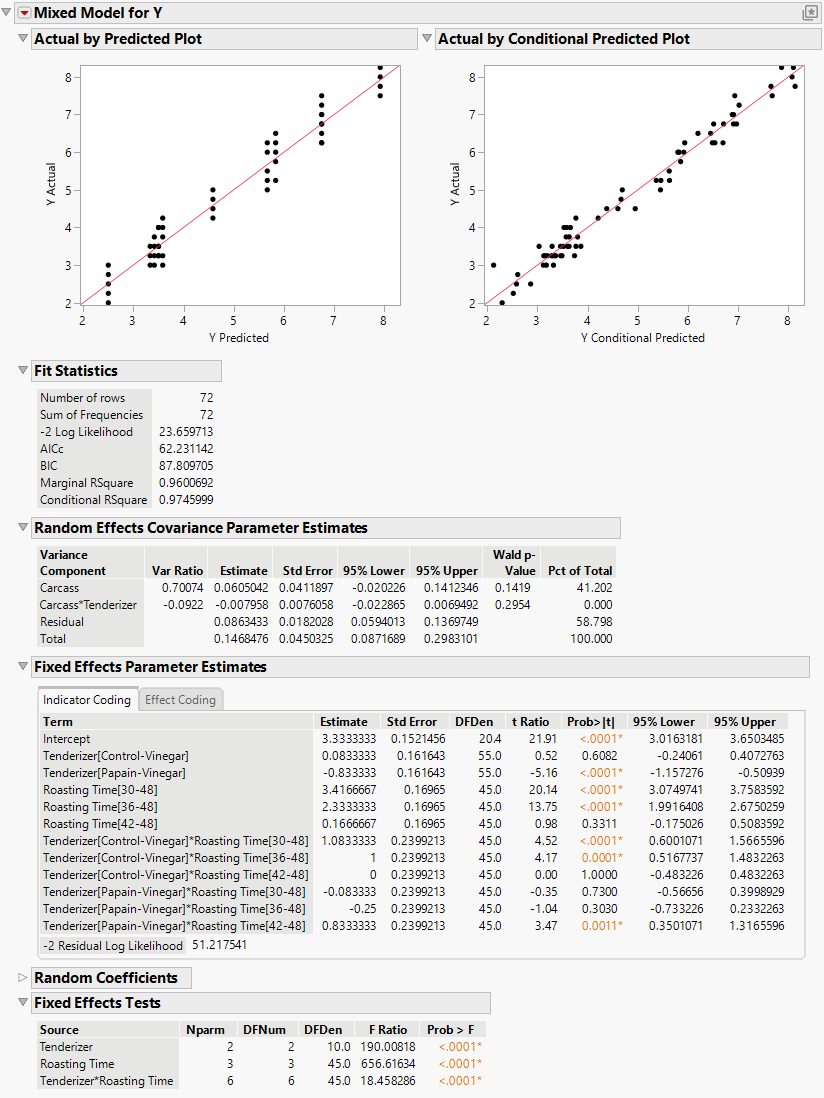

9. Click Run.
The Mixed Model report is shown in Figure 8.29.
The Actual by Predicted Plot and the Actual by Conditional Predicted Plot show no issues with model fit, so you can proceed to interpret the results. The Fixed Effects Tests report indicates that there is a significant interaction between tenderizer and roasting time.
Figure 8.29 Mixed Model Report
Mixed Model Report

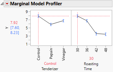

1. Click the Mixed Model red triangle and select Marginal Model Inference > Profiler.
Figure 8.30 Marginal Model Profiler with Roasting Time Set to 30 Minutes
2. Move the red dashed vertical line in the Roasting Time panel to 36, 42, and 48.
In Figure 8.30, notice that both the papain and vinegar tenderizers result in significantly lower tenderness scores than the control when roasting time is either 30 or 36 minutes. However, at 42 minutes, there are no significant differences. At 48 minutes, papain gives a value lower than the control, but vinegar does not. Papain gives lower tenderness scores than does vinegar at all times except 42 minutes.

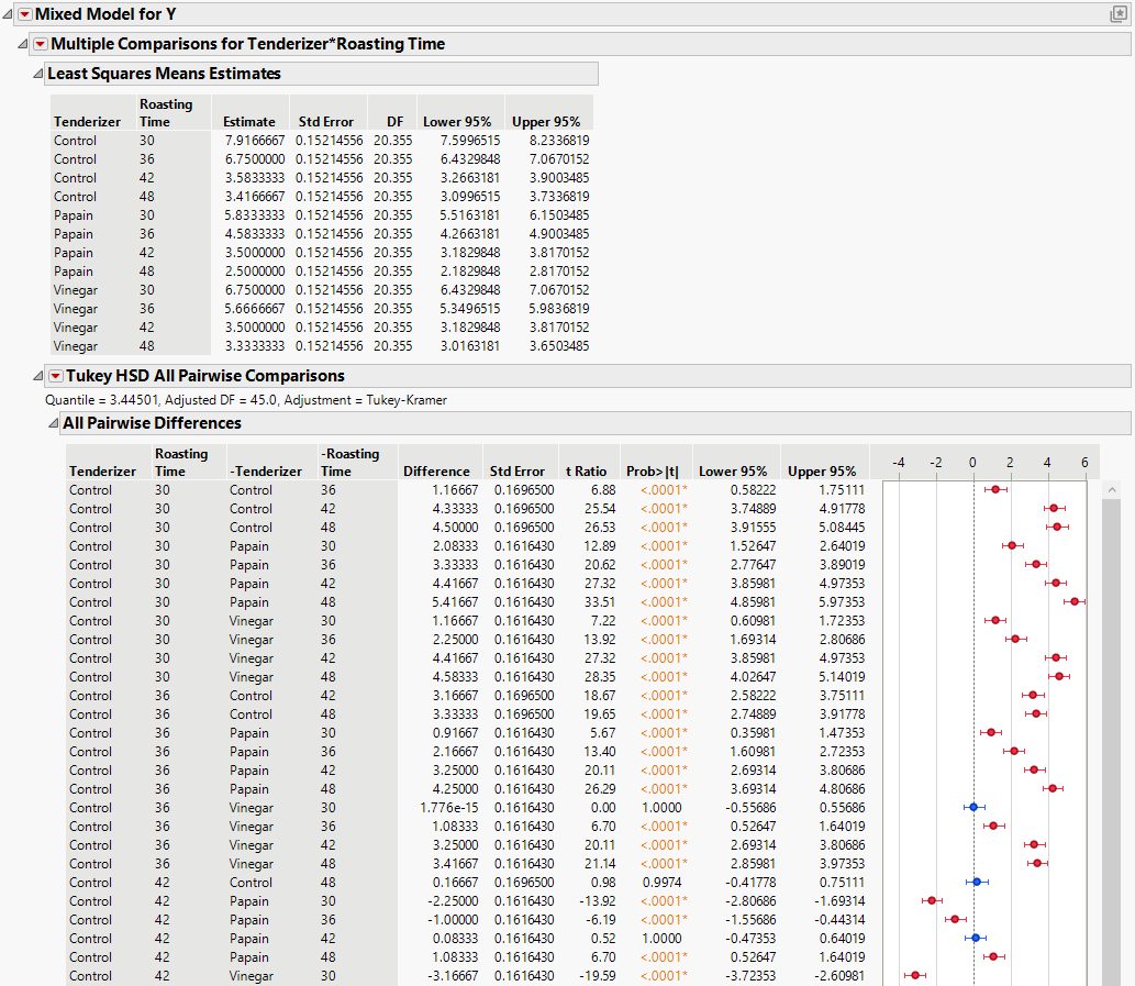

3. Click the Mixed Model red triangle and select Multiple Comparisons.
4. Select Tenderizer*Roasting Time.
5. Select All Pairwise Comparisons - Tukey HSD and then click OK.
Figure 8.31 shows a partial list of pairwise comparisons. Most of the differences between papain and vinegar that you observed in the profiler are statistically significant. Therefore, it appears that papain is the better tenderizer.
Figure 8.31 Multiple Comparisons, Partial View
