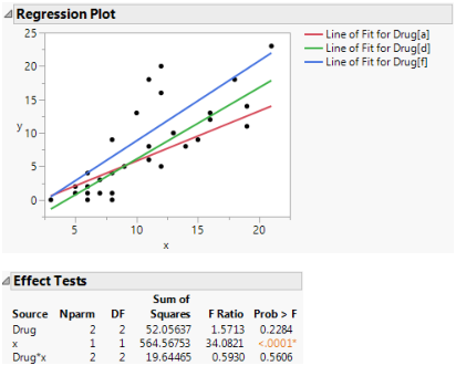

Regression Plot and Effect Tests
Use the Regression Plot to assess the model and to understand the impact of the covariate on the response. Use the Effects Tests for statistical tests of significance of the model effects.
Figure 4.23 Regression Plot and Effect Tests with Interaction
The Regression Plot shows that the response for Drug d and f increases at similar rates over the covariate, x. The response for Drug a tends to increase at a slower rate than for the other two drugs over the covariate, x. However, the Effect Test for the interaction has a p-value of 0.56. This is not significant, which indicates that the model does not need to include different slopes.

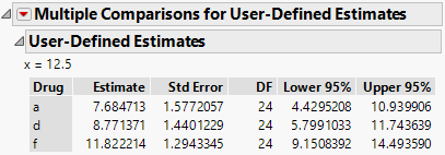

The User-Defined Estimates report shows least square means estimates for each level of Drug with the covariate x set to 12.5. The Multiple Comparisons for User-Defined Estimates red triangle menu contains options that enable you to test for differences among the estimates.

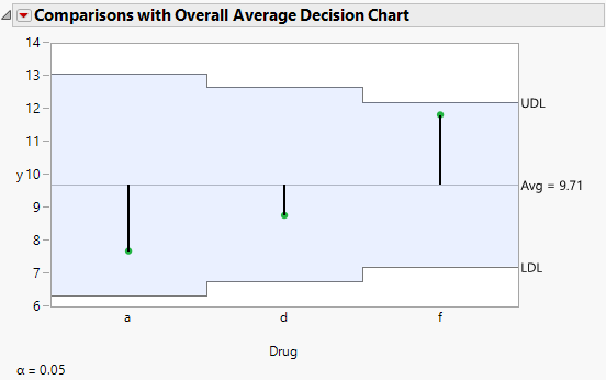

7. Select Comparisons with Overall Average from the Multiple Comparisons for User-Defined Estimates red triangle menu.
Figure 4.25 Comparisons with Overall Average Decision Chart
The Comparisons with Overall Average option shows an analysis of means (ANOM) chart for differences between the average and the three least squares means. From the ANOM chart, you conclude that there is not a significant effect of Drug on the response at x = 12.5.
