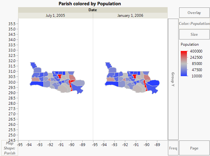

Create the Map in Graph Builder
Once the map files have been set up, you can use them. The Katrina.jmp data table contains data on Hurricane Katrina’s impact by parish. You want to visually see how the population of the parishes changed after Hurricane Katrina.
1. Select Help > Sample Data Folder and open Katrina.jmp.
2. Right-click the Parish column and select Column Properties > Map Role.
3. Select Shape Name Use.
4. Click the Map name data table button Image shown here and browse to select Parishes-Name.jmp, which you previously created.
This tells JMP where the data tables containing the map information reside.
5. Select PARISH from the Shape definition column list.
In Parishes-Name.jmp, the PARISH column has the Shape Name Definition Map Role property assigned. The column consists of map shape data for each parish.
6. Click OK.
7. Select Graph > Graph Builder.
8. Drag and drop Parish into the Map Shape zone.
The map appears automatically, since you defined the Parish column using the custom map files.
9. Drag and drop Population into the Color zone.
10. Drag and drop Date into the Group X zone.
Figure 12.20 Population of Parishes Before and After Katrina

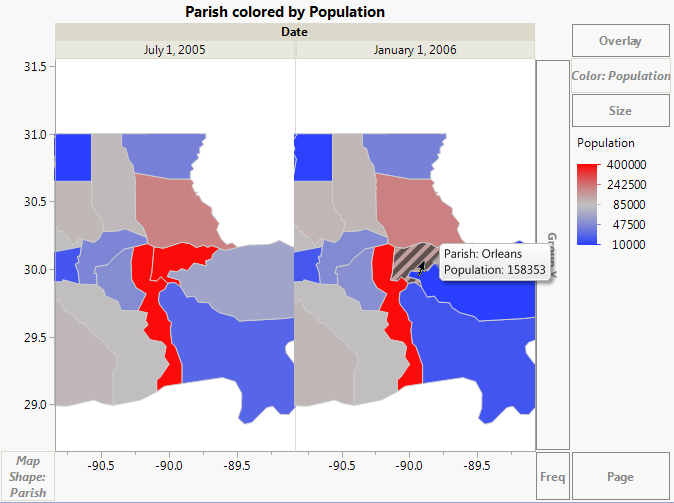

11. Select the Magnifier tool to zoom in on the Orleans parish in both maps (Figure 12.21)
Figure 12.21 Orleans Parish
Orleans Parish
You can clearly see the drop in population as a result of Hurricane Katrina. The population of the Orleans parish went from 437,186 in July 2005 to 158,353 in January 2006.

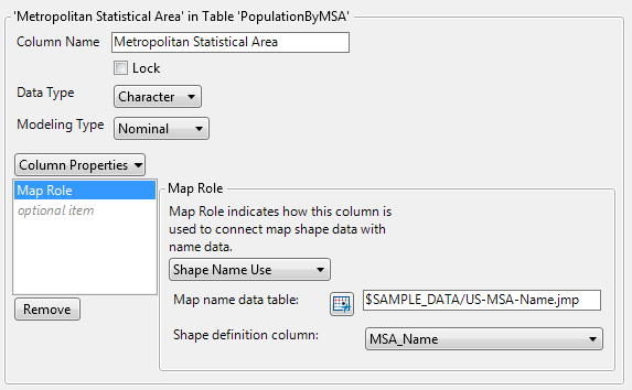

Add the Map Role Column Property
1. Select Help > Sample Data Folder and open PopulationByMSA.jmp.
2. Right-click the Metropolitan Statistical Area column and select Column Info.
3. Select Column Properties > Map Role.
4. Select Shape Name Use.
5. Next to the Map name data table, type $SAMPLE_DATA/US-MSA-Name.jmp.
6. Select MSA_Name from the Shape definition column list.
MSA_Name is the specific column within the US-MSA-Name.jmp data table that contains the unique names for each metropolitan statistical area. Notice that the MSA_Name column has the Shape Name Definition Map Role property assigned, as part of correctly defining the map files.
Note: Remember, the Shape ID column in the -Name data table maps to the Shape ID column in the -XY data table. This means that indicating where the -Name data table resides links it to the -XY data table, so that JMP has everything that it needs to create the map.
Figure 12.22 Map Role Column Property
7. Click OK.

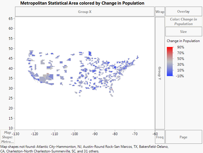

Once the Map Role column property has been set up, you can perform your analysis. You want to visually see how the population has changed in the metropolitan statistical areas of the United States between the years 2000 and 2010.
1. Select Graph > Graph Builder.
2. Drag and drop Metropolitan Statistical Area into the Map Shape zone.
Since you have defined the Map Role column property on this column, the map appears.
3. Drag and drop Change in Population to the Color zone.
Figure 12.23 Change in Population for Metropolitan Statistical Areas

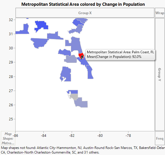

4. Select the Magnifier tool to zoom in on the state of Florida.
5. Select the Arrow tool and click the red area.
Figure 12.24 Population Change of Palm Coast, Florida

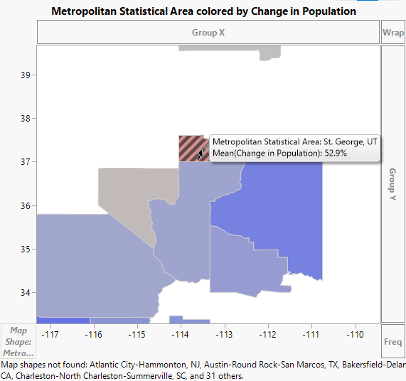

7. Select the Magnifier tool and zoom in on the state of Utah.
8. Select the Arrow tool and click the area that is slightly red.
Figure 12.25 Population Change of St. George, Utah
You can see that the areas of Palm Coast, Florida, and St. George, Utah had the most population change between 2000 and 2010. The Palm Coast area saw a population change of 92%, and the St. George area saw a population change of about 53%.
