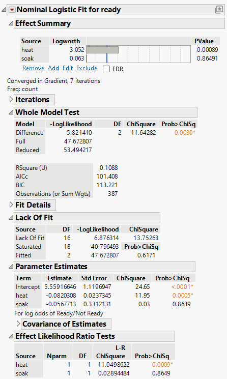

7. Click Run.
When the fitting process converges, the nominal regression report appears.
Figure 12.2 Nominal Logistic Fit ReportĀ
In the Whole Model Test report, the chi-square statistic (11.64) has a small p-value (0.0030), which indicates that the overall model is significant. However, the parameter estimate for soak has a p-value of 0.8639, which indicates that soaking time is not statistically significant.

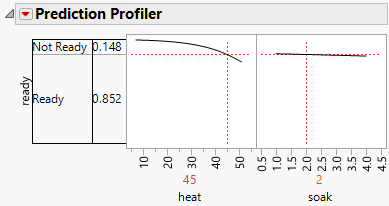

8. Click the red triangle next to Nominal Logistic Fit for ready and select Profiler.
Figure 12.3 Prediction ProfilerĀ
Prediction Profiler
When heat is set at 45 and soak is set at 2 the probability of ready is 0.85.
