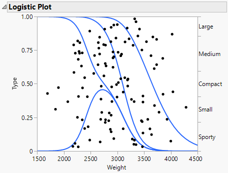

Figure 12.1 Logistic Plot for a Nominal Logistic Regression ModelĀ
