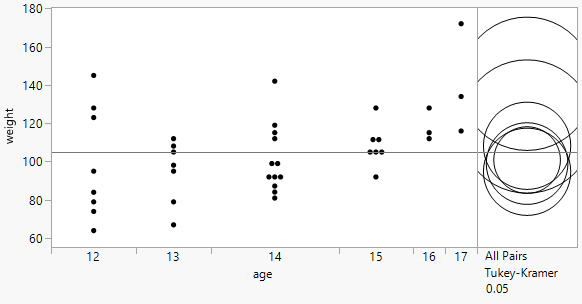

This example uses the Oneway platform to illustrate the Tukey HSD test.
1. Select Help > Sample Data Folder and open Big Class.jmp.
3. Select weight and click Y, Response.
4. Select age and click X, Factor.
5. Click OK.
6. Click the Oneway Analysis red triangle menu and select Compare Means > All Pairs, Tukey HSD.
Figure 6.15 All Pairs, Tukey HSD Comparison Circles

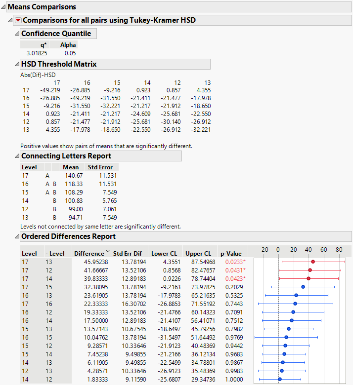

Figure 6.16 Means Comparisons Report for All Pairs, Tukey HSD
In Figure 6.16, the Tukey-Kramer HSD Threshold matrix shows the actual absolute difference in the means minus the HSD. Pairs with a positive value are statistically significantly different at the specified alpha significance level. The q* value in the confidence quantile table represents the quantile that is used to scale the HSDs. It has a computational role comparable to the quantile in a Student’s t test.
