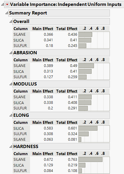

The Summary Report is shown in Figure 3.29. Because the importance indices are based on random sampling, your estimates might differ slightly from those shown in the figure.
The report shows tables for each of the four responses. The Overall table averages the factor importance indices across responses. The factors in the Prediction Profiler (Figure 3.30) have been reordered to match their ordering on the Overall table’s Total Effect importance.
Figure 3.29 Summary Report for Four Responses

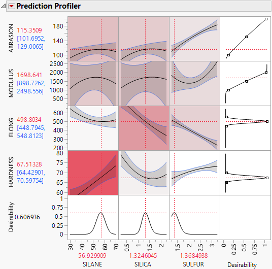

4. Click the red triangle next to Variable Importance: Independent Uniform Inputs and select Colorize Profiler.
Colors from a red to white intensity scale are overlaid on profiler panels to reflect Total Effect importance. For example, you easily see that the most important effect is that of Silane on Hardness.
Figure 3.30 Prediction Profiler for Four Responses

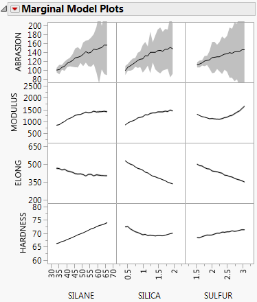

The Marginal Model Plots report shows mean responses for each factor across a uniform distribution of settings for the other two factors.
Figure 3.31 Marginal Model Plots for Four Responses
