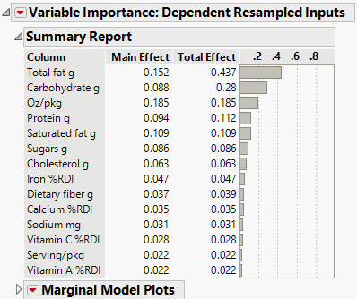

Because the factors are correlated, you take this into account by choosing Dependent Resampled Inputs as the sampling method for assessing variable importance.
10. Click the Prediction Profiler red triangle and select Assess Variable Importance > Dependent Resampled Inputs.
Figure 3.27 Dependent Resampled Inputs ReportĀ
The Variable Importance: Dependent Resampled Inputs report appears. Check that the Prediction Profiler cells have been reordered by the magnitude of the Total Effect indices in the report. In Figure 3.27, the Total Effect importance indices identify Total fat g and Carbohydrate g as the factors that have most impact on the predicted response (0.437 and 0.28, respectively). Similarly, Oz/pkg and Protein g have positive Total Effects, though slightly smaller in magnitude (0.185 and 0.112, respectively).

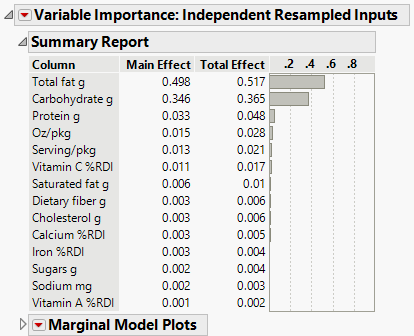

You might be interested in comparing the importance indices obtained assuming that the factors are correlated, with those obtained when the factors are assumed independent.
11. Click the Prediction Profiler red triangle and select Assess Variable Importance > Independent Resampled Inputs.
Figure 3.28 Independent Resampled Inputs ReportĀ
The resampled inputs option makes sense in this example, because the distributions involved are not uniform. The Variable Importance: Independent Resampled Inputs report shows that Total fat g and Carbohydrate g are still identified as having the most impact on the predicted value (0.514 and 0.379, respectively). Similarly, Protein g and Oz/pkg have positive Total Effects, though significantly smaller in magnitude (0.05 and 0.03, respectively). Compared to Figure 3.27, the Total Effect importance indices for Total fat g and Carbohydrate are slightly increased, however, the same indices for Oz/pkg and Protein g are decreased drastically. This highlights the variations in Variable Importance measures based on the resampling method used.
