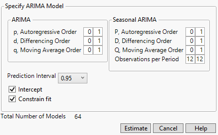

12. Click the Time Series LEADPROD red triangle and select ARIMA Model Group.
13. Set the range for all parameters from 0 to 1. The Specify ARIMA Model window looks like the one in Figure 18.24.
Figure 18.24 ARIMA Model Group Specifications
14. Click Estimate.

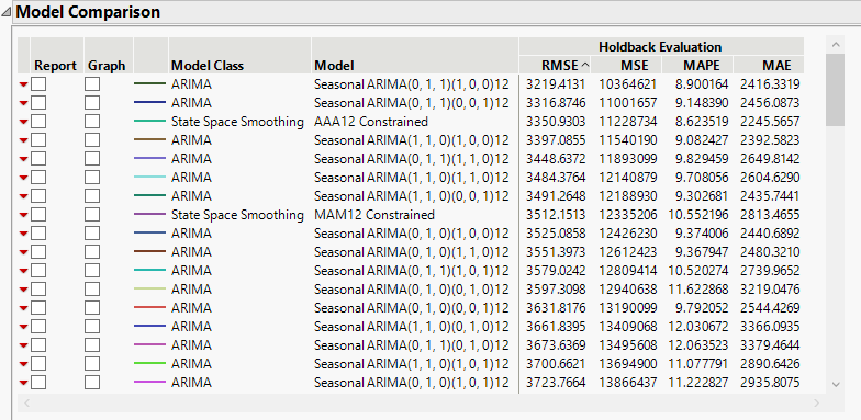

Figure 18.25 Model Comparison
Model Comparison
The fit statistics are comparable between the State Space Smoothing models and the ARIMA models because they are evaluated on the holdback set.

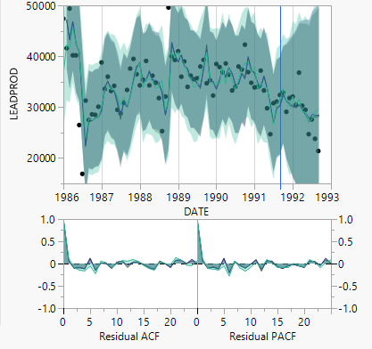

15. Select the Graph check box next to the first three models in the Model Comparison report.
Figure 18.26 Model Comparison Graph
The evaluation statistics and the forecasting plots show that there is no substantial differences in forecasting performance among the top models. Based on the report, either an ARIMA model or a State Space Smoothing model is appropriate for this data.
