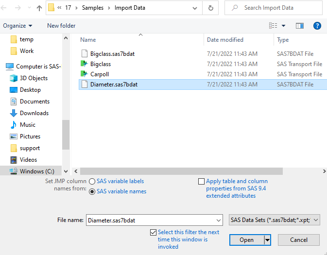

1. Select File > Open.
2. (Windows only) Select SAS Data Sets from the list next to File name as shown in Figure 3.50.
Note: SAS variable names and formats are preserved and can be saved after changes are made to the SAS data set. See Save JMP Data as a SAS Data Set.
3. Select the file.
Figure 3.50 Open SAS Data Set
Open SAS Data Set
Note: To select the columns to import, click the arrow on the Open button and select Select columns.

5. (Optional on Windows) Select any of the following options:
Apply table and column properties from SAS 9.4 extended attributes
If the SAS server supports extended attributes (SAS 9.4), includes the extended attributes when storing JMP metadata. This setting overrides the SAS 9.4 Extended Attributes preference on the Third Party Data page.
Select this filter the next time this window is invoked
Sets the default file type choice to the option that you select next to the File name list If selected, the default file type will be SAS Data Sets the next time you reach this window.
