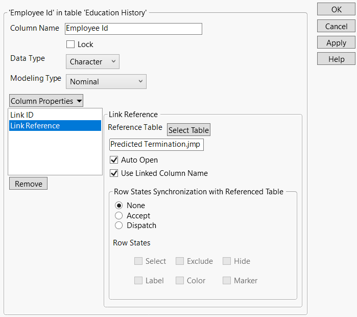

To add the Link Reference column property, select the column, select Cols > Column Info, and then select Link Reference from the Column Properties list. Enter the path to the main table and click OK. If you enter the path correctly, the referenced columns show up in the Columns panel of the main table after you click OK.

• Consider putting the data tables in the same folder. Then you can omit the directory name from the Link Reference property and include only the data table name. Otherwise, include the full path to the data table (such as C:\users\marie\My Data.jmp).
• You can also increase portability by using a JMP path variable in the Link Reference path. Figure 5.10 shows an example. Enter a forward slash in the path to share the data tables with both Windows and macOS users. See Path Variables in the Scripting Guide for more information about path variables.

• Select Auto Open to open the linked table automatically when the main data table is opened. See Update Data Tables.
• You can specify that the linked column name be used in virtually joined columns. This option lets you specify a shorter column name (for example, Cheese instead of Cheese[Choice]). In the Link Reference column property, select Use Linked Column Name.
Figure 5.10 Link Reference Column Property Definition
