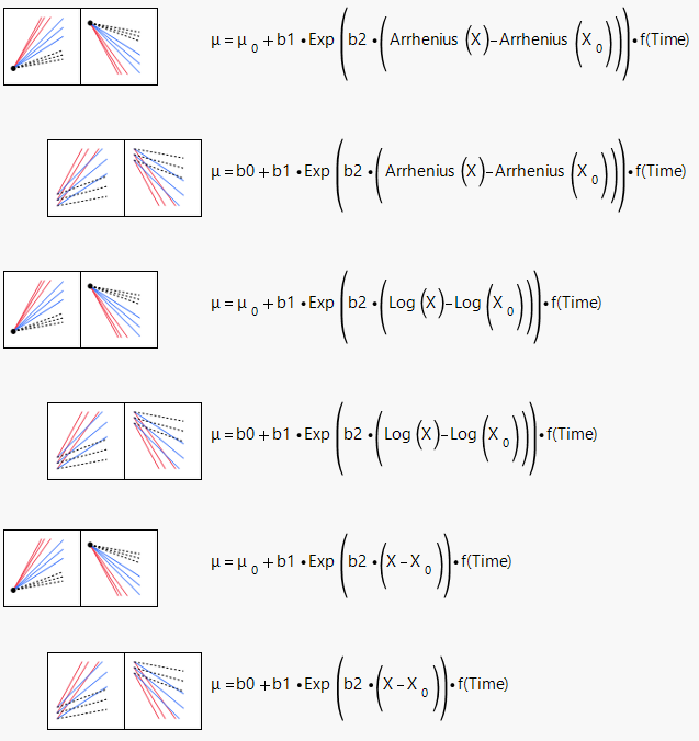

If you do not specify an X variable in the launch window, there are 6 models available. These models are listed in Figure 8.9. The models appear in pairs, where the first of each pair having a fixed intercept and the second of each pair having a random intercept.
Figure 8.9 Models Without an X Variable

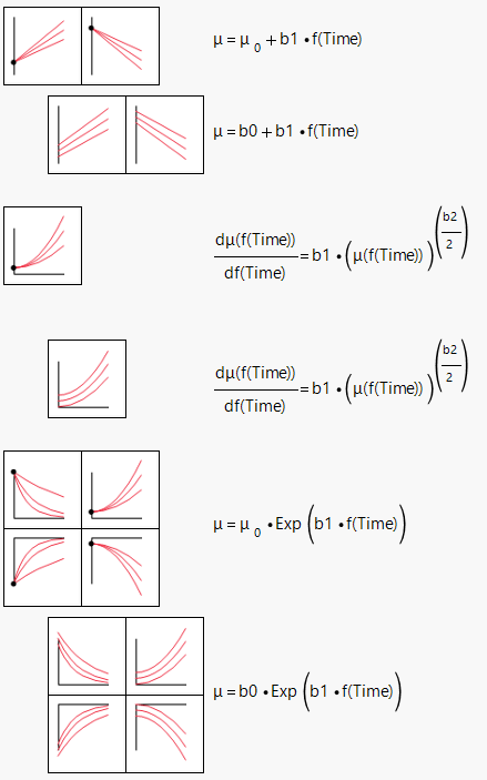

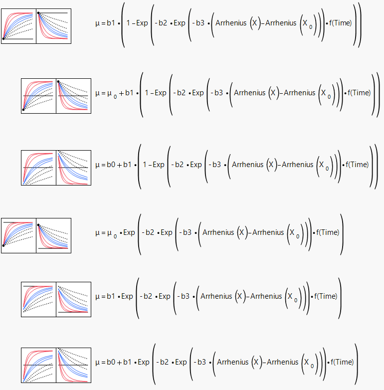

When you specify an X variable in the launch window, additional models are available in the Path Definition panel. Figure 8.10 shows the first-order kinetics models. Figure 8.11 shows the constant rate models.
Note: The indented models are variations of the unindented models immediately preceding them. The variation is that the initial condition is shifted or that the initial conditions are random.
Figure 8.10 First-Order Kinetics Models
Figure 8.11 Constant Rate Models
