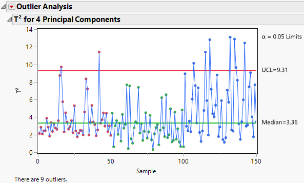

In the Principal Components platform, the Outlier Analysis report displays the T2 for <A> Principal Components plot by default. The plot shows the T2 value for each observation and horizontal lines at the Median and Upper Control Limit (UCL). For more information about how the T2 values, median, and UCL are calculated, see Statistical Details for Outlier Analysis Calculations.
The α level used to calculate the UCL is displayed next to the plot. The number of outliers detected is shown below the plot. This number is the number of observations with T2 values that are greater than the UCL.
Figure 4.11 Outlier Analysis Report
Tip: Hover over a point in the T2 Plot to view the T2 Contribution Proportion Plot for that observation. Click the T2 Contribution Proportion Plot to add it to the report window.
