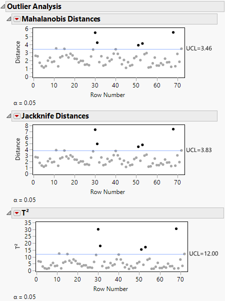

In the Multivariate red triangle menu, the Outlier Analysis option contains a submenu of three distance measures to use for outlier detection. Each option in the submenu shows or hides a plot that measures distance in the multivariate sense, with respect to the correlation structure. Testing is done at the alpha level that appears at the bottom of the plot.

The following distance measures options are available:
Mahalanobis Distances
Shows or hides the Mahalanobis distance of each point from the multivariate mean (centroid). The standard Mahalanobis distance depends on estimates of the mean, standard deviation, and correlation for the data. The distance is plotted for each observation number. Extreme multivariate outliers can be identified by highlighting the points with the largest distance values. See Mahalanobis Distance Measures.
Jackknife Distances
Shows or hides distances that are calculated using a jackknife technique. The distance for each observation is calculated with estimates of the mean, standard deviation, and correlation matrix that do not include the observation itself. The jack-knifed distances are useful when there is an outlier. In this case, the Mahalanobis distance is distorted and tends to disguise the outlier or make other points look more outlying than they are. See Jackknife Distance Measures.
T2
Shows or hides distances that are the square of the Mahalanobis distance. This plot is preferred for multivariate control charts. The plot includes the value of the calculated T2 statistic, as well as its upper control limit. Values that fall outside this limit might be outliers. See T2 Distance Measures.
Figure 3.6 Outlier Analysis PlotsĀ
