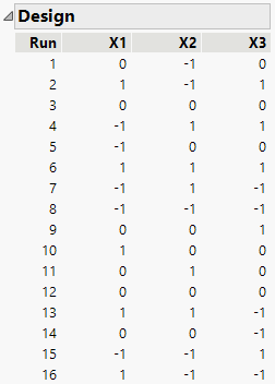

The Design section shows the design.
Figure 5.24 RSM Design
RSM Design
In order to estimate quadratic effects, a response surface design uses three levels for each factor. Note that the design in Figure 5.24 is a face-centered Central Composite Design with two center points.

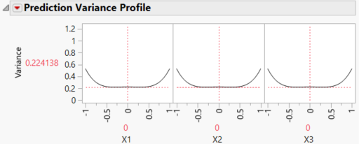

13. Open the Design Evaluation > Prediction Variance Profile section.
Figure 5.26 Prediction Variance Profile
The vertical axis shows the relative prediction variance of the expected value of the response. The relative prediction variance is the prediction variance divided by the error variance. When the relative prediction variance is one, its absolute variance equals the error variance of the regression model.
The profiler shows values of the relative prediction variance over the design space. You can move the sliders to explore the prediction variance’s behavior. The prediction variance is smallest in the center of the design space. It is fairly constant, with values only slightly larger than 0.2, for factor settings between -0.5 and 0.5. The prediction variance increases as the settings approach the design space boundaries.

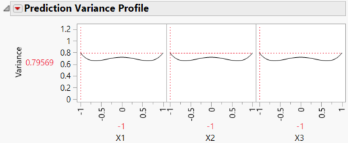

14. Click the Prediction Variance Profile red triangle and select Maximize Variance.
Figure 5.27 Prediction Variance Profile with Relative Variance Maximized
The profiler shows that the maximum value of the relative prediction variance is 0.79569.

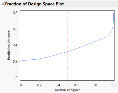

15. Open the Design Evaluation > Fraction of Design Space Plot section.
Figure 5.28 Fraction of Design Space Plot
The blue curve in the plot shows the relative prediction variance as a function of the fraction of design space. The red dashed cross hairs indicate that, for 50% of the design space, the prediction variance is about 0.32 or less. Use the cross hair tool to draw other inferences. For example, when the Fraction of Space is 0.95, the Prediction Variance is about 0.52. This means that for 95% of the design space, the relative prediction variance is below 0.52.

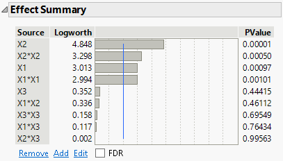

The Effect Summary report shows the Logworth and PValue for each effect in the model. The vertical blue line in the plot is set at the value 2. A Logworth that exceeds 2 is significant at the 0.01 level.
Figure 5.29 Effect Summary Report
The report shows that X1, X2, X1*X1, and X2*X2 are significant at the 0.01 level. None of the other effects are significant at even the 0.10 level. Reduce the model by removing these insignificant effects.

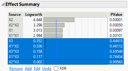

4. In the Effect Summary report, select X3, X1*X2, X3*X3, X1*X3, and X2*X3.
Figure 5.30 Effect Summary Report with Insignificant Effects Selected
5. Click Remove.
The Fit Least Squares report is updated to show a model containing only the significant effects: X1, X2, X1*X1, and X2*X2.

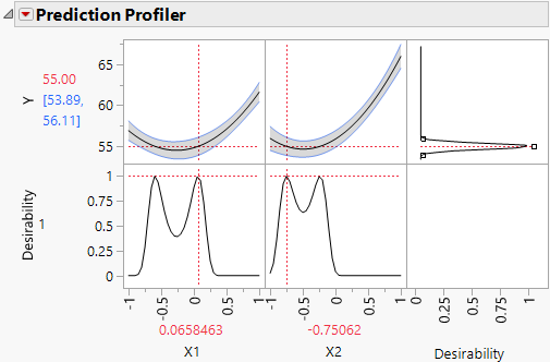

Use the Prediction Profiler (at the bottom of the Fit Least Squares window) to explore how the predicted response (Y) changes as you vary the factors X1 and X2. Note the quadratic behavior of Y across the values of X1 and X2.
Remember that you entered response limits for Y in the Responses section of the Custom Design window. As a result, the Response Limit column property is attached to the Y column in the design table. The Desirability function for Y (in the top plot at right) is based on the information contained in the Response Limit column property. JMP uses this function to calculate Desirability as a function of the settings of X1 and X2. The traces of the Desirability function appear in the bottom row of plots.
6. Click the Prediction Profiler red triangle and select Optimization and Desirability > Maximize Desirability.
Figure 5.31 Prediction Profiler with Desirability Maximized
The predicted response achieves the target value of 55 at the process settings shown in red above X1 and X2. Notice that a value of X1 near –0.65 also achieves a predicted value of about 55 when X2 = -0.75062. In fact, your Prediction Profiler might show different settings that maximize desirability. This is because a predicted response of 55 can be obtained with multiple settings of X1 and X2.

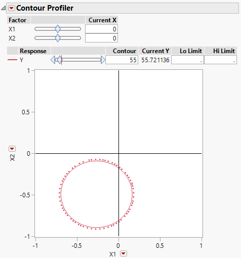

7. Click the Response Y red triangle and select Factor Profiling > Contour Profiler.
8. In the Contour Profiler report, type 55 as the value for Contour.
Figure 5.32 Contour Profiler
Contour Profiler
The settings of X1 and X2 that correspond to the red contour have predicted response values of 55. You might want to select from among these process settings based on cost efficiency.
