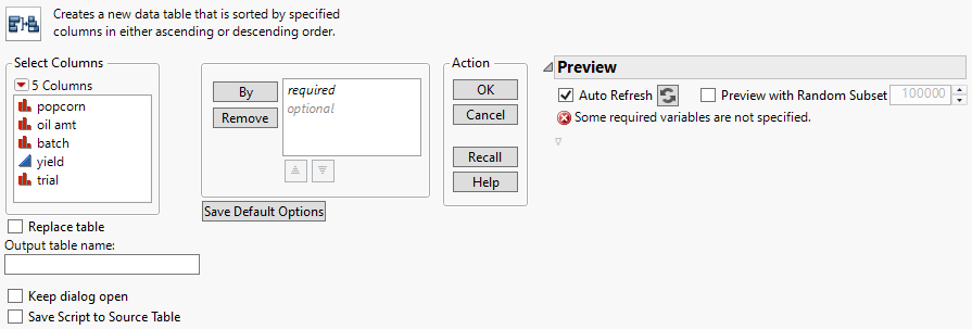

Figure 6.5 The Sort Window
The Sort Window

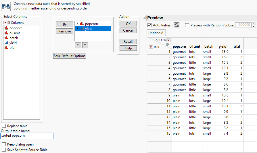

Figure 6.6 Completed Sort Window
