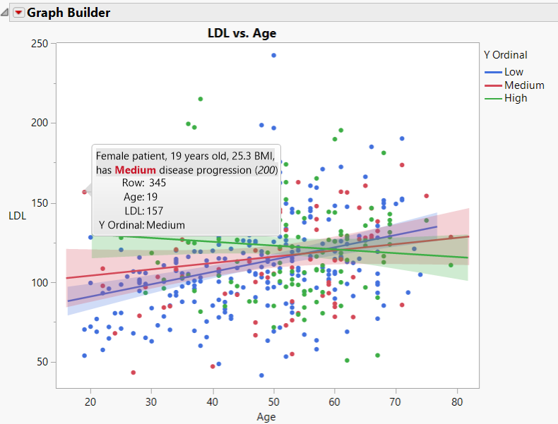

A textlet adds richly formatted text to the hover label in a JMP graph. You might use a textlet to describe data in an explanatory paragraph or to emphasize important information by making it bold or applying a color.
The textlet in Figure 12.39 shows text that is formatted in a gray box with red text.
Figure 12.39 Textlet Example
Textlet Example
The following script creates the textlet shown in Figure 12.39.

	/* markup defines the rich text template. It supports HTML-like markup such as bold, italic and other font tags. Variable references between braces ({}) are substituted with their actual value. */
	Markup(
		"{local:gender} patient, {local:_age} years old, {local:BMI} BMI,
		has <font color='{local:color}'><b>{local:_Y Ordinal}</b></font>
		disease progression (<i>{local:progression}</i>)"
