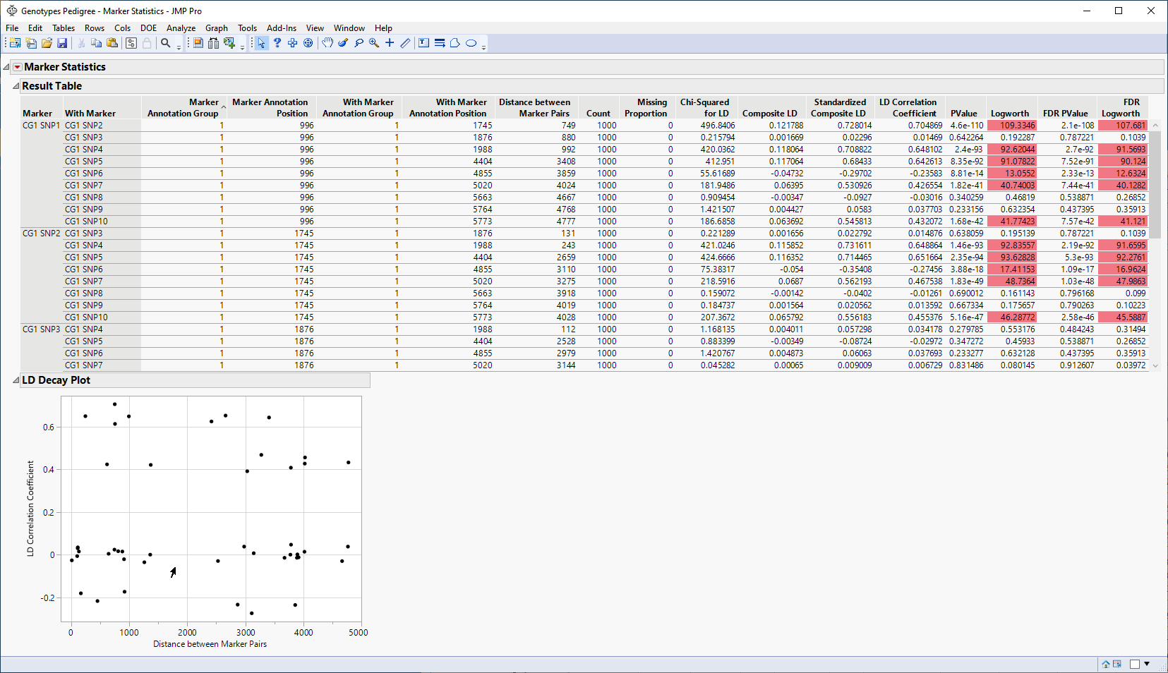

1. Select Help > Sample Data Folder, open Life Sciences, and then open Genotypes Pedigree.jmp and Genotypes Pedigree Anno.jmp.
2. Select Analyze > Life Sciences > Marker Statistics.
3. Click on the Markers disclosure icon to show the Marker columns.
4. Select the first ten marker columns and click Marker.
5. Select the same ten markers and click With Marker.
6. Select the Use Annotation Table check box.
7. Click OK.
8. In the Choose Annotation Table window, select the Genotypes Pedigree Anno.jmp annotation data table.
9. In the Annotation Specifications window, select Marker and click Marker Variables.
10. Select Gene and click Annotation Group.
11. Select Physical Position and click Annotation Position.
12. Click OK.
Figure 3.4 Analysis of Linkage Disequilibrium
In the Result Table, the values shown for each pair of markers are indicative of the strength of linkage disequilibrium between the pair. In the LD Decay Plot, notice that linkage disequilibrium generally declines exponentially as the distance between the markers increases.
