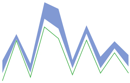

Range
Shows the area that corresponds to the difference in the summary statistic for the merged variables.
Image shown here
Stacked Range
Shows the areas that correspond to the difference in the summary statistic after the variables are stacked.
Image shown here
