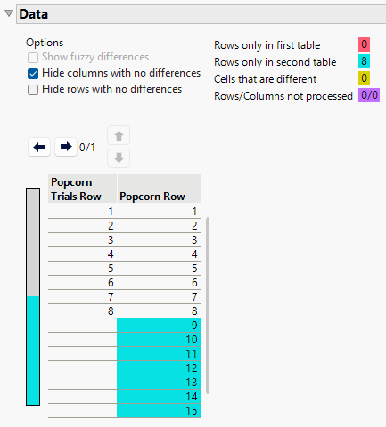

The results are shown in the Data report.
Figure 4.26 Comparing Columns
Comparing Columns
The first eight rows are the same, so they are not shown. The remaining rows (colored blue) are only in the second table, Popcorn.jmp.
6. In the Data report, deselect Hide rows with no differences.
Figure 4.27 Showing Rows with No Differences
The first eight rows are shown because they are the same in both data tables.

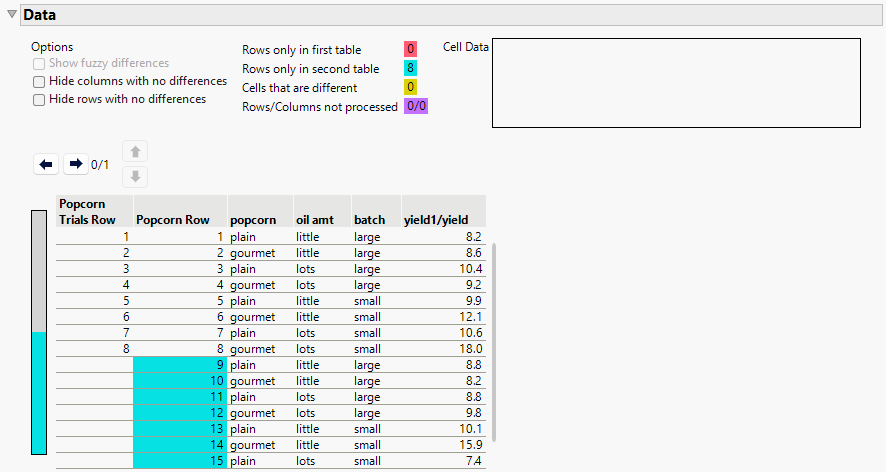

7. Deselect Hide columns with no differences.
Figure 4.28 Showing Columns with No Differences
Columns that are in both data tables and that match are shown. You might select this option to give more context to the matched data.
Note: If the data in a cell is not completely shown, select the text and then view the data in the Cell Data box.

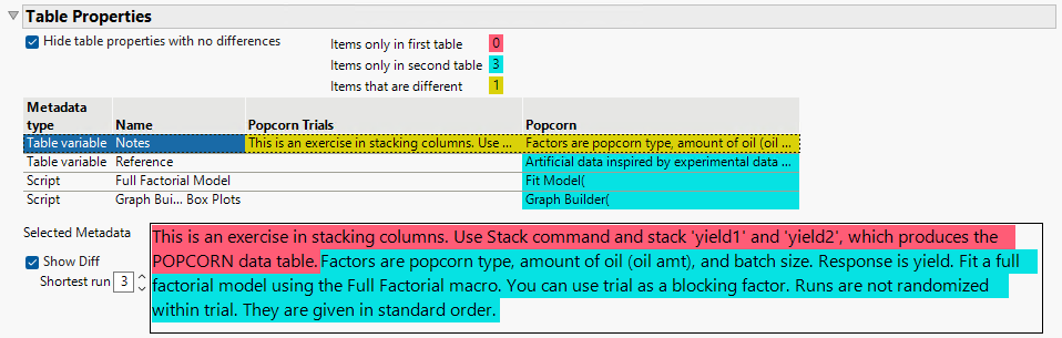

Compare Table Properties
Click the Compare Data Tables red triangle and select Compare Table Properties to see differences in table scripts and variables. Figure 4.29 shows that the table variables and scripts are different. To see the full variable or script, select the line and view the selected metadata.
In this example, both notes differ, and the reference variable and scripts are only in Popcorn.jmp. The Notes variable is selected so that you can see its contents for both data tables in the Selected Metadata box. The red shading indicates that the text is only in Popcorn.jmp. The blue shading indicates that the text is only in Popcorn Trials.jmp.
Figure 4.29 Different Table Variables
Deselect Show Diff to see the name of each data table and the complete contents of each Notes variable instead of only showing the differences.
Shortest run is the smallest number of consecutive characters that are required to be the same (between the two files) before you can declare the characters as a common subsegment. A common subsegment has no background color because it is present in both files. The shortest run is set to 3 to prevent subsegments that are too short from showing up as common, which is typically unhelpful. For example, a shortest run of 1 means that any single character that is in both files could match. This leads to many very short segments of common text and differences, which is usually not a good reading experience.

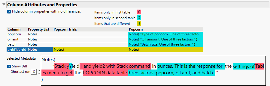

Compare Column Attributes and Properties
Click the Compare Data Tables red triangle and select Compare Column Attributes and Properties to see differences in column notes, value colors, and so on.
Figure 4.30 shows that column notes are different in Popcorn.jmp and Popcorn Trials.jmp. The yield1/yield column is selected so that you can see the complete note and differences between the two notes in the Selected Metadata box.
Figure 4.30 Comparing Column Attributes and Properties
