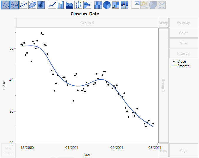

3. Select Close and click Y.
4. Select Date and click X.
Figure 4.32 Overlay Plot with Smoother

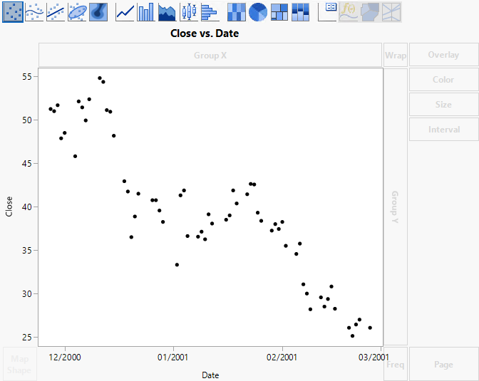

5. Click the Smoother button (Image shown here) to remove the smoother line.
Figure 4.33 Overlay Plot of the Closing Price over Time
Interpret and Interact with the Overlay Plot

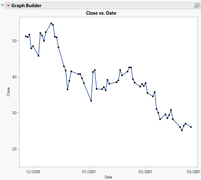

The overlay plot shows that the closing stock price has been decreasing over the last several months. To see the trend more clearly, connect the points.
1. Press Shift and click the Line button (Image shown here) . Pressing Shift applies additional types without deselecting other types.
Figure 4.34 Connected Points
Connected Points
The potential investor can see that although the stock price has gone up and down over the past three months, the overall trend has been downward.

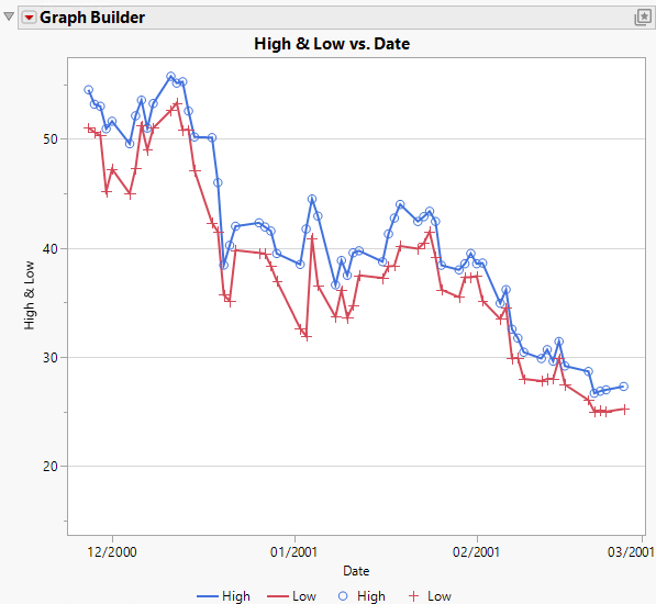

Use an overlay plot to plot more than one Y variable. For example, suppose that you want to see both the high and the low prices on the same plot.
1. Follow the steps in Create the Overlay Plot of the Stock’s Price over Time, but this time assign both High and Low to the Y role.
2. Connect the points and add grid lines as shown in Interpret and Interact with the Overlay Plot.
Figure 4.35 Two Y Variables
Two Y Variables
The legend at the bottom of the plot shows the colors and markers that are used for the High and Low variables in the graph. The overlay plot shows that the High price and Low price closely track each other.
